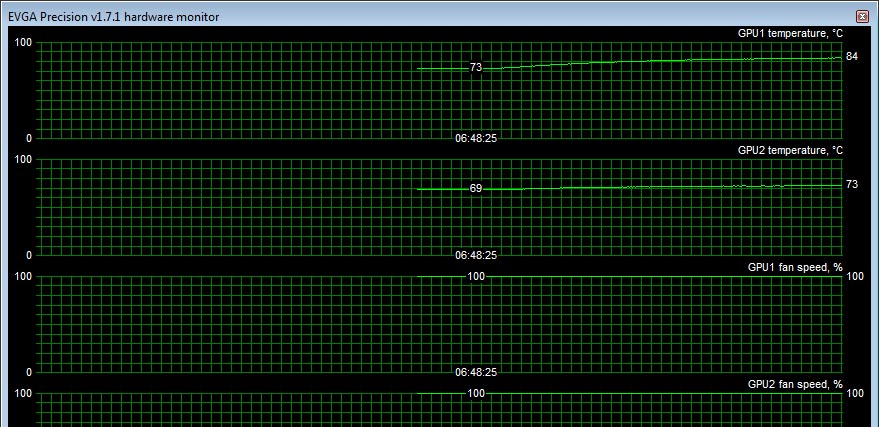

I'm running a pair of GeForce GTX 280's for the folding team and have the fans at 100% and the shaders overclocked up to 1500MHz from 1350MHz for better performance. The noise from the fans being at 100% was getting annoying, so I put the case door back on the CoolerMaster Cosmos case and look what it did to the temperature in minutes...
It went from 73C to 84C on one of the GPU's... I took the door off and it went back down to 72-74C range... For the first GPU... Amazing difference.

Does overclocking the shaders put that much more heat out ? seems a tad high for the fan to be at 100% on that gpu.
Re: Removing The Case Door While Folding Helps Lower Temperature
Posted: Fri Jun 12, 2009 5:14 pm
by werty316
Upping the shaders for folding doesn't increase heat at all. Drop the core & memory clocks; up the shaders and fold on.

InspectahACE wrote:Does overclocking the shaders put that much more heat out ? seems a tad high for the fan to be at 100% on that gpu.
At idle they run 51/55.... under load they run 74/85C
Right now both GPUs are working on project 5911 and the PC keeps locking up... ;(
Not sure what the deal is right now. I got the case door off, the cards running at factory clocks with the fans at 100%... no screen saver... no clue... Temps are 62/65 right now since it's 7am and I cranked down the A/C overnight.
