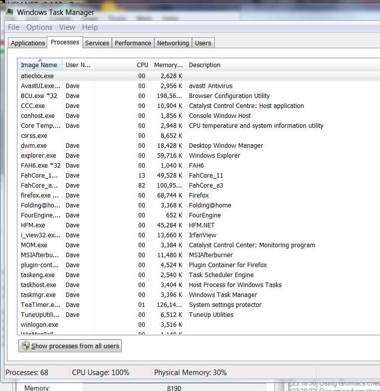

pull up your task manager and post what fahcore_A3.exe is using for resources (should be at least 83%)

by rat6fink
bouncing from 79% to 83%.

stop folding on the 5770, it doesn't put up enough ppd to matter and is just taking a core away from your 1055

skier wrote:stop folding on the 5770, it doesn't put up enough ppd to matter and is just taking a core away from your 1055
is FAH6 SMP2 or GPU2? all my clients come up as [email protected] etc.
and regardless of the hardware you run, GPU3 is bad, and SMP1 is bad (but it seems like you have SMP2)
okee dokee...FAH6 is the SMP2 client...I changed the file name, per the instructions on the website...
on the 5770, I was folding GPU2. I read that the GPU3 was a bad idea, so went with the GPU2.
GPU2 is shut down as I type this, and SMP is un-hung, but still showing no run times.
**EDIT:now running
WOW! THAT was an improvement!!!!! :supz: :supz:

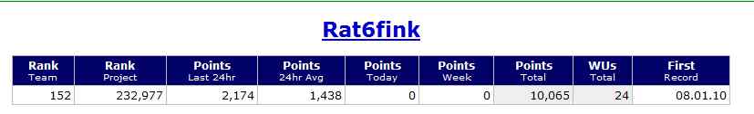

i also just noticed, why does it say you have 53,000,000 points with 109,000 on the 24hr?
Re: SMP Issue
Posted: Sat Aug 28, 2010 10:38 pm
by rat6fink
skier wrote:i also just noticed, why does it say you have 53,000,000 points with 109,000 on the 24hr?
HUH?!?!?!?!!
Re: SMP Issue
Posted: Sun Aug 29, 2010 6:33 am
by skier
look at your hfm
