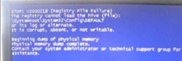

Anyone have any idea on how to solve this one? BSOD happens when loading windows after the mouse and keyboard are detected. When entering safe mode it locks up and restarts. Sorry for the bad picture, but the BSOD is so fast I had to video tape the monitor and do a freeze frame.
Just found this on Microsoft.com...
How to Troubleshoot a Stop 0xC0000218 Error Message
SYMPTOMS
A Windows-based computer displays the following Stop error message:
Stop 0xc0000218 (0xe11a30e8, 0x00000000, 0x000000000,0x00000000)
UNKNOWN_HARD_ERROR
-or-
Stop: 0xc0000218 {Registry File Failure}
The registry cannot load the hive (file):
\SystemRoot\System32\Config\SYSTEM or its log or alternate.
It is corrupt, absent, or not writable.
NOTE: The parameters in parentheses are specific to your system configuration and may differ each time.
CAUSE
A Stop 0xc0000218 error message means that a necessary registry hive file could not be loaded. This error message can occur if the file is corrupt or missing. To resolve this issue, you can reinstall the operating system and restore the registry files from a backup. The registry files may have been corrupted because of hard disk corruption or some other hardware problem.
This error message can also occur if the driver has corrupted the registry data while loading into memory, or the memory where the registry is loading has a parity error. In the latter case, turn off the external cache and check the memory chips.
RESOLUTION
To resolve this issue, follow these steps:
1. Start your computer by running the Recovery Console, run the chkdsk /p command on the drive, and then restart your computer. Test to determine whether the issue is resolved. If the issue is resolved, do not complete the remaining steps. If the issue is not resolved, go to step 2.
2. When Windows loads, press SPACE BAR when the "Load Last Known Good" message appears.
3. Complete a parallel installation, and restore the registry files from a tape backup. To do so:
• Reinstall Windows in a separate folder.
• Restore the damaged registry hive from backup. This procedure is specific to the backup application that you used to make a backup. Consult the documentation of your backup application or consult the vendor if you need assistance. Typically, this procedure requires you to restore a system state backup to an alternate location, and then copy the appropriate registry files to the %SYSTEMROOT%\System32\config folder of the damaged operating system.
• If you do not have a tape backup, include the backup of network servers and production workstations.
NOTE: If Windows is stored on a FAT partition, you can restore the files by using another computer and by copying the registry hive files to the %SYSTEMROOT%\System32\Config subfolder.

New one on me. sorry, do you know what could have futz up the registry yet?
-Thomas Jefferson
figured it out... Had a bad set of Corsair Dominator PC2-8500 Memory Modules... Put in a pair of Corsair Dominator PC2-9136 Memory and it runs fine... BLEH
