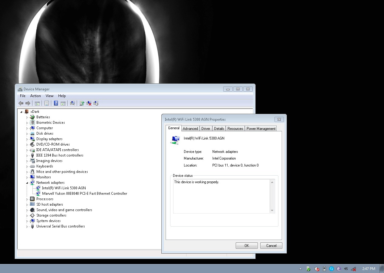

Post by sbohdan » Mon Mar 02, 2015 7:57 am
So I just bought an Intel wifi link 5300 wifi card for my Dell M1530 laptop and it doesn't work. It shows that everything is fine in the device manager but the wifi icon in the tray shows no wifi card. I tried to uninstall, reinstall the drivers but nothing worked and I have no idea what else to do. The wifi does work if I get the other wifi card I have in my other dell XPS M1530 but this card does the ssame in both laptops. The card is brand new and is the second I bought that does the same. The first one I thought was deffective but I don't suppose 2 new cards from different vendors would be faulty. Any ideas?

Post by sbohdan » Tue Mar 03, 2015 12:52 pm
Nope. When I put in the card from the other Dell I have, that one works. This card doesn't work in the other laptop also (I have 2 same XPS M1530's). I just can't believe 2 different cards from 2 different vendors I ordered would be broken. It is a possibility though.

Post by sbohdan » Thu Mar 26, 2015 11:24 am
So nobody appeared to be able to give me any advice on this forum, so I figured it out myself and am sharing the sulution to the above problem:
As I described it before, non of the wifi cards worked in one of my laptops (they all worked in the other one). I tried to uninstall and install over and over from device manager, cleaning after with 5 different driver and registry cleaners but nothing helped. Finaly I have gone into safe mode and when I opened the device manager, under the "network adapters" section, there was the Ethernet adapter + there was a hundred + "microsoft 4 to 6 adapters. Now these did not appear in regular windows, so since I had nothing to loose, I just uninstalled them all. Took me about 10min. to do it all. After it was done, I ran 2 registry and driver cleaners and shut down the laptop. I installed one of the wifi cards and... lo and behold: it just worked!
