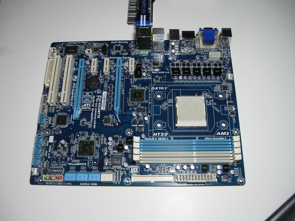

well it's finally in my hands, Phenom II X6 1055T 2.8GHz 9MB
picture time: before i really get into things, the 'test system' GA-890GPA-UD3H rev. 1 with BIOS F5(need to flash sometime)

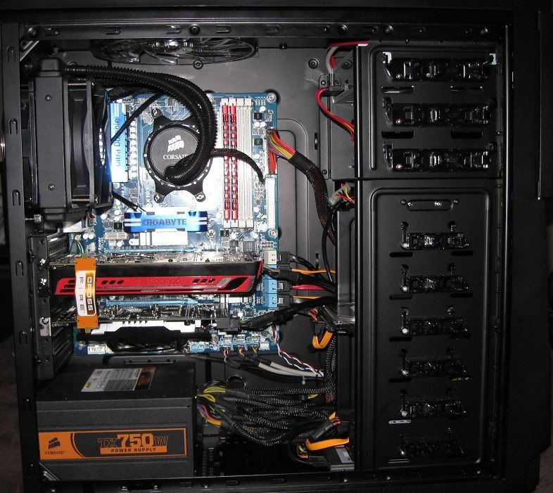

all my hard drives moved over from the Core2Quad system including my new Seagate Momentus XT 500GB 2.5" Hybrid HDD which is now my primary system drive
http://i164.photobucket.com/albums/u37/ ... G_3497.jpg

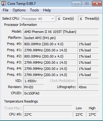

interesting sight here, at idle the cores bounce around from x4 to x14(which is set in BIOS manually)
http://i164.photobucket.com/albums/u37/ ... retemp.jpg
To start: Idle temps: 23ish, load is a firm 38C (2hr prime95) in a ~77 degree room(which is rather nice as it's a humid 97 outside)

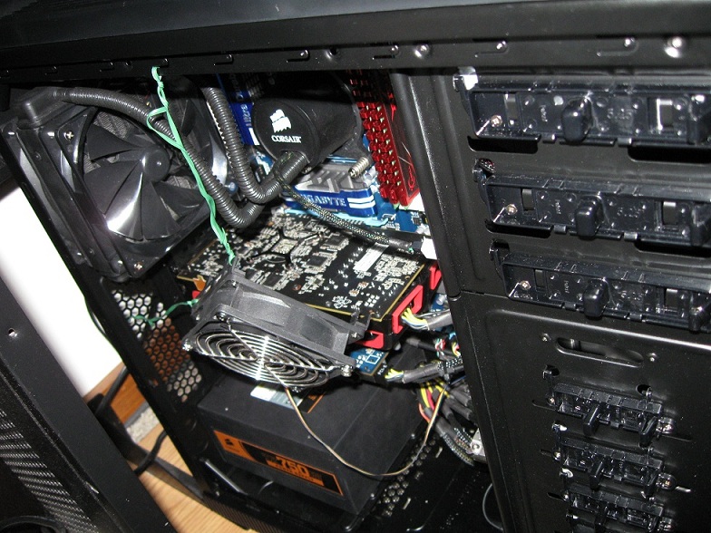

the Ripjaw kit has been twisting my arm(blend would crash and or error within seconds or blue screen randomly) because i have to run it around either 1300MHz or 1800MHz because of the ratio and it won't run below its default 1.5v, but i have it at 1424MHz 8-8-8-22 now 21min prime95 blend stable with the 1055T @3737MHz :) so the ram is good to go since it'll only be going closer to spec from here on up, so its back on the CPU to be tweaked, its running at 48C now though because i've been running the small FFT test which threw it up at 53C(to verify RAM was the problem) and hasnt been idle to stabilize much, btw my northbridge fan:
yes, held on by the kind of ties you use to close trash bags(got a 50ft spool of it a couple years ago, great way to spend $2.50), and its the 92mm rocketfish fan from my other cpu cooler(running a different 92mm 3pin fan on a fan controller on the Q8300 system) pushes a lot of air
edit IV: 279x14=3905MHz 10min blend stable, 48C

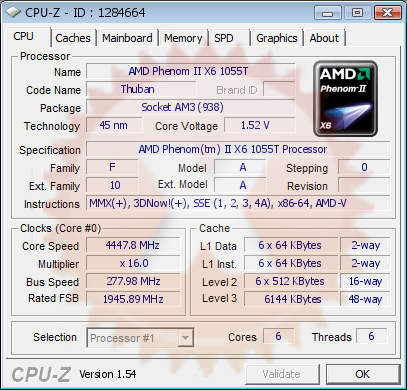

OHAI TURBO
need to try getting it to boot at 16.5 turbo but this is good :D

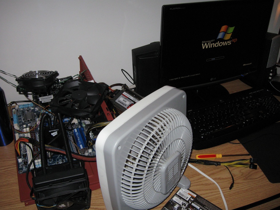

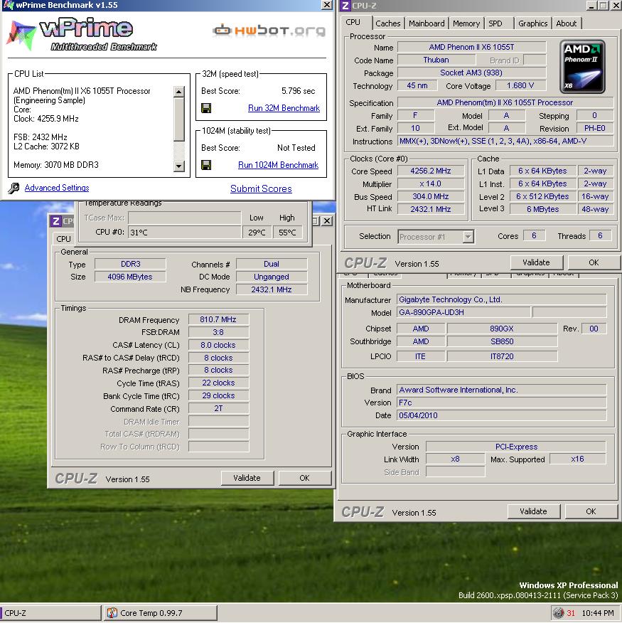

my initial goal was to beat 6.00sec and i'd say i met that goal
also ran the 1024M at 4.116GHz but didnt like the temps so i didnt run it at any higher freq. than that
one 92mm fan on NB, one 120mm hiflow on PWM, window fan, the dual fan rad for the H50, ~75F room temp

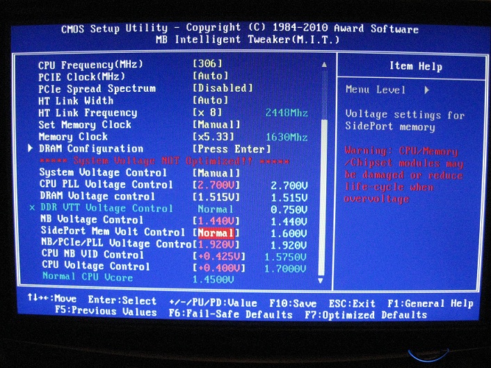

wouldn't boot above 304MHz even with 1.7v vcore and all the other voltages in the orange:
(ignore the 306 bus, took the pic after just changing that)
-Austin
