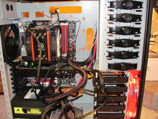

Cables are a little messy since I'm just testing the parts out.
I was impressed with the Frio's base; it's actually very flat! On the other hand, the finish wasn't the best in the world, but still pretty good.
The First RAM slot was blocked by the fan, but I still got them to run in dual-channel using the other available slots.

The CPU the case is all opened up (like in the image above) and the fans are running all at low.

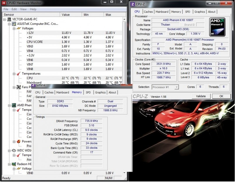

Room temp is 14C or so...idle temp: 23C, load is 35C for stock speeds so far.

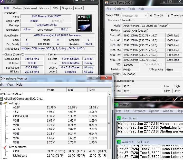

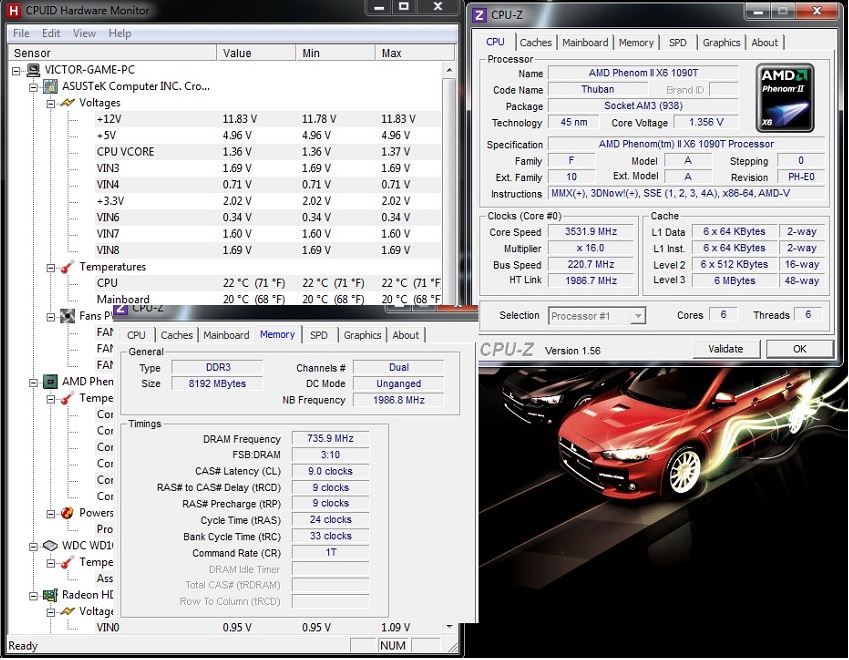

Got it to a 3.5GHz OC so far by adjusting like...nothing.
Ran Prime95 for 2 hours and it's stable; max temp is 37C. Again, fans are set to lowest RPM. Just realized the Vcore is set to auto in BIOS. I'll see what happens when I put it on manual.
Skier (or anybody else that would like to give some tips), I may need some of your OC'ing assistance every now and then since you've seem to have had some pretty good overclocking with your 1055T.
Re: Phenom II 1090T build
good rule of thumb for all Phenom II's (thuban or deneb) is that you can get 220 fsb on default voltage, then a small voltage bump for up to around 240 then another around 255/260 then you have to really start feeding it voltage
FSB clocking of course, I've never personally had an unlocked multi, but I would imagine the vcore would be similar regardless of FSB based on the frequency you are running (ie 300x14 runs at similar voltage as 200x21 even though the FSB is vastly different they are both still 4.2)
also keep your HTT between 1950-2200, never go above 2200. CPU-NB is ideal around 2700-3000 if you are close to 4GHz though you may not be able to get it quite that high, higher the better
and the usual you can't get much above 1700MHz on DDR3 RAM stable on AMD systems regardless of reference speeds for the RAM, its an IMC limitation (CPU-based)

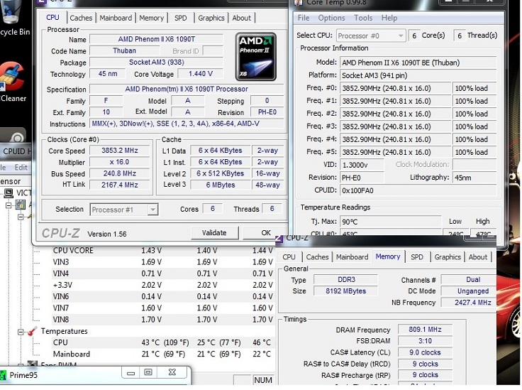

Running at 3.69Ghz...again I left voltages to auto just to see. vCore stays at around 1.35v for idle and jumps to almost 1.4v while running p95...
Looks like I'll need around 1.4v for around 3.7Ghz. I'll most likely need to bump the other voltages up as well.
Manually adjusted the voltages and it's running at 3.85Ghz (16 x240). Bumped the vCore to 1.4v, and CPU-NB, HT, NB, SB, CPU VDDA, and VDDR up one or two. Max temp seems to be 46/47C with cpu fans running at @2500+ RPM on the Frio...MY GOD IT IS LOUD
By the way, which one is PLL voltage on the Corsshair IV Formula? VDDR or CPU VDDA? It seems that PLL voltage = CPU VDDA...which default is 2.5v?!
EDIT: no voltages were changed (which is surprising), and i uped the Multi from x16 to x17. Reached 4.09Ghz!!
Let's hope it's p95 stable...
EDIT2: Damn! Knew 4Ghz can't be that easy to get with like no voltage changes at all. BOSD'ed after like 10min of Prime95. Good thing I didn't have to clear CMOS thanks to the Mobo feature
. I better run Prine95 for 6+ hours at 3.8Ghz to make sure that's stable first.

Uhhh...I think I may need some help.
I ran P95 for 2 hours at 4Ghz (250x16) at 1.5v

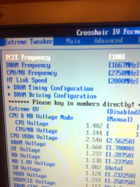

My problem is that I can't get my RAM STABLE! My G.Skill ripjaws are able to run at 1333 9-9-9-24 2T, but not at 1666...Prime95 just fails within 1 minute.
Anybody have any ideas?
BTW, Temps and voltages :
- Max 54C while running Prime95
- NB 2750Mhz
- HT 2000Mhz
- Vcore: 1.5v
- CPU/NB: 1.28
- CPU VDDA 2.56v
- DRAM tried 1.66v all the way to 1.7v; still no go @ 1666Mhz
- HT 1.28v
- NB 1.237v
- SB 1.23v
- VDDR 1.25v

They're G.Skill DDR3 1600MHz 8GB (2 X 4GB) 9-9-9-24. The voltage on the packaging says 1.5v. I'm at school right now so that's all the info I can give right now.skier wrote:nowhere have you listed specs for the RAM, so i cant help you yet there, all I know is that for my 1600MHz CL9 1.5v 2x2 kit I can run at 1.5v alllll the way to 1.545v (for CL9 ~1730MHz), outside that voltage range regardless of frequency or timings WILL NOT boot, if i'm running at DDR3 1066 it still has to run at 1.5v. and less memory capacity/DIMMs means better clocking so you cant clock a 2x4g kit as well as a 2x2g kit to begin with, and 4x2g kits are the worst.

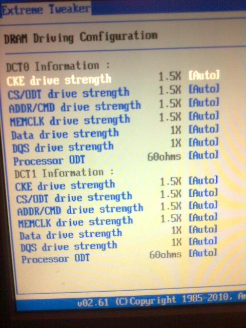

I can bring the DRAM multiplier down and have them running at 1333Mhz. If I put the multiplier up one , it becomes 1666Mhz. I run P95 and basically encounters and error right away. The PC doens't crach of anything, P95 stops running.
Here are some phots if that helps.

as I thought, CPU VDDA is actually PLL, mine was running 2.70v when I blew caps and basically killed the CPU with p95, so keep that under 1.6v no matter what
for the RAM, don't run it over rated specs until you are completely done tweaking the CPU, just because RAM is always the most finicky part of your system, so run it on the 1333 divider with 1.5v and at probably CL7-8-7-20 should be fine
keep in mind (Tight Timings > High Frequency)

Thanks!skier wrote:as I thought, CPU VDDA is actually PLL, mine was running 2.70v when I blew caps and basically killed the CPU with p95, so keep that under 1.6v no matter what
the stock voltage for PLL was 2.5v, and -as you can see in the pics- I've brought it up only a little bit to 2.54/2.56v. Shuold I leave at 2.5v OR lower it to 1.6v???
I was also able to run it at 1666MHz with CL-9-10-9-24-1T fine; Would 1333 CL-7-8-7-20 still be better?
I'll keep you guys updated.

lordvic wrote:Thanks!skier wrote:as I thought, CPU VDDA is actually PLL, mine was running 2.70v when I blew caps and basically killed the CPU with p95, so keep that under 1.6v no matter what
keep in mind (Tight Timings > High Frequency)![]()
and I would say if you can squeeze CL7 stable then go for it. I ran my RAM at ~1450 CL7-8-7-20

Haha I thought so.skier wrote:lordvic wrote:Thanks!skier wrote:as I thought, CPU VDDA is actually PLL, mine was running 2.70v when I blew caps and basically killed the CPU with p95, so keep that under 1.6v no matter what
I'll keep you guys updated.meant 2.6v max, my UD3H also ran default 2.5v
Alight, I'll give that a try in the morning (it's late at night here) and post some results.

Is your DRAM voltage really set at 1.7v? That memory is only rated 1.5v, aren't you worried you will damage it?

Haha that's odd, the last time I checked the time was before I went to bed..and it was around 1amskier wrote:fully aware how late it was haha posted at 3:22amlordvic wrote:Haha I thought so.
good luck
Anyways, I've got the RAM running at C7-8-7-20-1T @ 1.5v; seems to be working quite well
I realized that soon after, I quicky lowered it back down to ~1.55v after that.Kaos Kid wrote:Is your DRAM voltage really set at 1.7v? That memory is only rated 1.5v, aren't you worried you will damage it?
