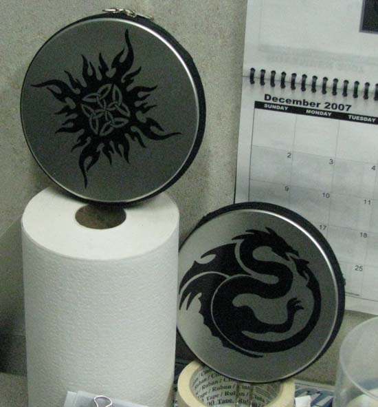

LOL forgot... I don't have a close up shot, I'll try and find where my kids threw them. These were stocking stuffers for my kids, the little snots just threw'em to the side :? Oh well, guess thats what I get for being cheap.

Wow, those are some crisp lines on that stencil!
Hell, if your kids don't want them, I will take them off your hands!
Are those CD cases?

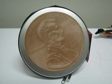

Yes, they are aluminum cases that I got in my junk mail at work. They had a big CD size sticker of a penny on them before I took it off.

huh its probably how much it cost them to make those things lol but I admit at first I thought you painted one to be a penny before I read your post lol.
