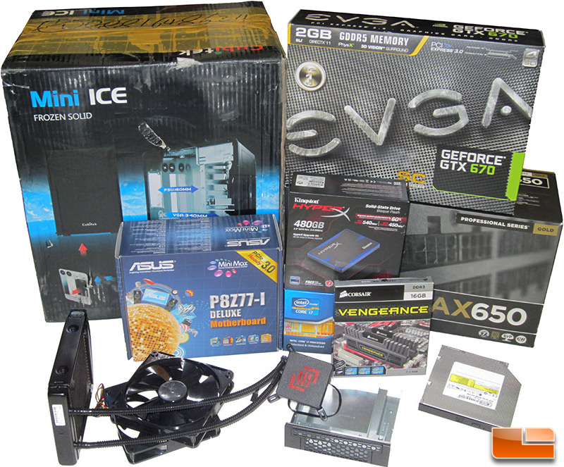

I've spent the past month gathering parts to build a Mini ITX system that would be able to run the Intel Core i7-3770K processor and the NVIDIA GeForce GTX 680 video card. I also wanted to run water cooling and be able to fit all this inside a Mini-ITX chassis. My part list after doing my research was a bit pricy, but this build will be epic:
Intel Ivy Bridge CPU - 3770K
ASUS P8Z77-I Deluxe mini-ITX Z77 Motherboard
Cubitek Mini-ICE ITX case
Kingston HyperX 480 GB SSD
CoolIT Eco II 140 Liquid Cooler (thanks to Maingear)
Samsung 8x DVD Burner
Notebook Optical Drive Adapter
Corsair AX 650W Gold PSU

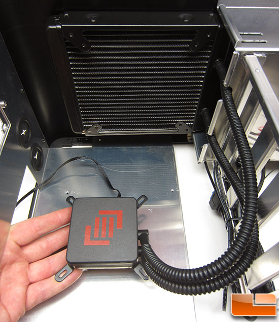

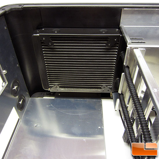

Well, I measured everything and built this whole design around the CoolIT Eco II 140MM water cooler as I wanted a water cooled Mini-ITX system and ran into the first two issues.

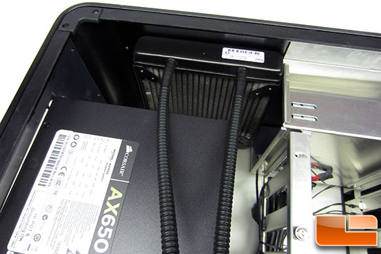

1) The push/pull dual fan configuration for the water cooler fits, but I forgot to factor in the PSU and the second fan won't fit do to the PSU being in the way. Looks like I am limited to a single fan.
2) The power supply location makes fitting the Water Cooler super tough as the stiff plastic tubing is not playing nice with the power supply or chassis.
I can run the hoses above the power supply, but they aren't long enough to bend around the PSU and attach to the socket. Flipping it 180 degrees runs the tubing straight into the motherboard.
Well, that way isn't going to work.

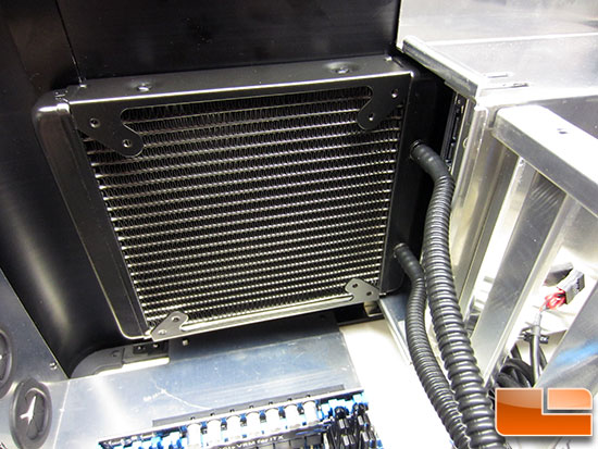

Hum, I have screws in the radiator... Nothing that a dremel can't fix right?
Re: My 2012 Project: Water Cooled Mini ITX PC w/ Ivy Bridge
I'd call that water tube routing issue fixed.

Damn man you made that circular cut with a Dremel? If so kudos to you. I can't cut a straight line with a Dremel. Looks good now keep the pictures coming.
Yeah, it wasn't too bad to get it cut out as I basicaly just sanded it. I found that works better for curves like this. It ate up a sanding band for each hole (linky), which is what I expected.

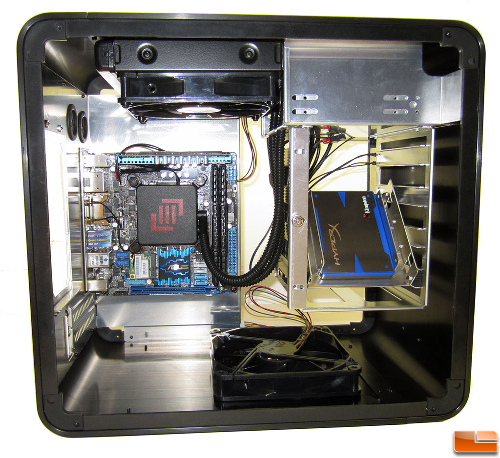

It looks like the water lines will tun down the hard drive cage and then turn and allow the water block and pump to fit flat against the mobo. The question now is will the power cable and SATA cables fit on the optical drive and will the water lines run over the top of the Corsair Vengeance memoty kit with the small heat spreaders.
It looks like the lines clear the memory and a quick test fit shows the Slimeline SATA Adapter touching the water hose... TIGHT TIGHT fit, but it looks like all the planning paid off and it will all work.

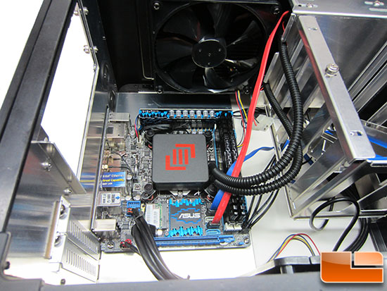

Getting closer to firing this bad boy up!
Oh and for the record... There is no place to run or hide wires in this case. Good thing is doesn't have any windows on the side panels!

Man that motherboard is tiny. The waterblock/pump really puts it into perspective. I really like this...

Got it all wired up...
Cubitek looks like they were sleeping on the job though...
Three of the wired were labeled power switch and had no other markings to make them distinguishable. Good thing I already had them zip tied... Never seen a case company do that in all my years of building PC's.

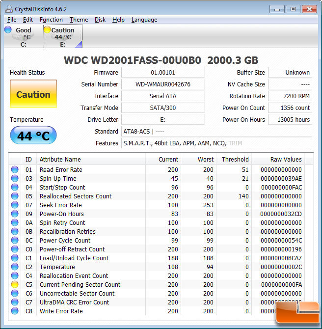

Looks like I'm building this at the right time... My WD 2TB Black Hard Drive just started knocking. I was going to move it over to this build, but I guess not.
