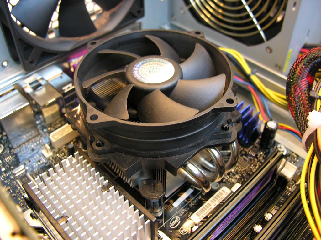

I guess I should kind of update this.
I swapped out my powersupply for a better one (still 500W, but much tighter voltage regulation (within 1% on most rails) and slightly more amps on 2 of the 12v rails), so my rig now looks like this:
If you have a keen eye, you will notice that my pipes are routed slightly different. This is because I have swapped round the radiator so that the barbs are at the front of the case now.
See no barbs here!
I did this so that I had better clearance between the pipes and the memory modules. I'm getting some CL3 800Mhz OCZ Reapers, and they have a heatpipe thing going on at top of the modules. With the pipes routed right on top of the memory before, they wouldn't have fit in the system. So I decided to swap round the radiator and the barbs on it.
I had to use 90 degree barbs, wasn't too keen on doing that due to restrictions, but in the cramped case there wasn't really anything else I could do. Note that due to how I had cut the radiator hole at the top, I had to remove the front drive blanks to accommodate the side of the radiator with the barbs in.
Yes, those tubes have been hacked at. But I can't see any of this as the P180 has a pretty case door that hides all that away. Interestingly, I think that allowing air to enter the case here has reduced the temperature in the water loop by a degree or two. The downside to the intake here will be dust buildup as there is no air filter there. I guess I could make one, but I doubt I can be bothered to

I decided that I need to update the pics on this thread...
(It might have something to do with methious' swamp thing thread being posed to about to overtake this thread for page views)
So here is the current state of my sexy rig.
(click to enlarge!)
Since the last updates, I've installed the 2GB OCZ Reaper Kit (3-4-4-15 @ 800Mhz @ 2.4v(!)), and have gotten a PC Power & Cooling 610W Silencer.
As far as tweaking goes I managed to get the timings of the RAM down to 3-4-4-11 @ 840Mhz @ 2.2v. Which doesn't sound much unless you know how hard the AW9D-MAX boards push the RAM subtimings. I'm hopeful if I take this kit over to another board I will be able to get faster Mhz out of the kit.
Here are some benchmarks at the different maximum points of my memory (i.e. fastest overclock with loose timings [green], default [blue], and fastest overclock at tightest timings [purple])
As for the PSU, with everything I can throw at it, and I mean everything, the voltages were read as follows:
