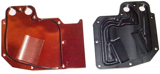

The XSPC has great internal flow for a full coverage block, but like you said, it more than likely won't fit. About the only solution you have right now would be GPU only blocks with sinks on the ram and v-regs.
