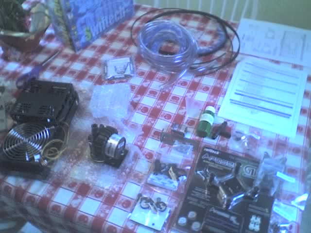

Well i have my watercooling stuff in today, and I'm going to put it together as soon as i get my case mods finished. breaking out the dremel right now but I'm wondering what procedure i should follow when getting my WC all setup. flushing radiator? do i have to? how do i do it? etc etc
I've got the instructions that came with the Swiftech Apex Ultima kit but thats all...

Re: watercooling prep
Start by flushing the radiator. I used off the shelf bottled water for that (made sure to get reverse osmosis filtered water). You want to do that to remove any left over solder or other metal bits from the interior of the radiator before you install it. You know, grindy bits that might take out thier revenge on your pump.
Once that's done install the radiator into the case. Start doing your plumbing. If you have trouble putting on your hoses on the barbs a little vasoline helps as it's not water soluable, won't damage the hoses, and is virtually water proof. Bio taught me that trick. Make sure you put the hoses on all the way to the bottom of the barb! That's the biggest rookie mistake. Push it on until it actually hits whatever the barb is coming out of. Then put your clamps behind the barb. Make sure they're snug.
Last tip is to make sure you only run your pump for a few seconds at a time. Let it flush the coolent through then give it a chance to "burp" the air back out of the loop. If you leave it run, it'll cavitate and burn out the motor. A AT PSU is great for this as you can turn the pump on and off independent of the rest of the system. Plus once the loop is filled you can let the AT PSU run for 10 min or so without turning on your system to make sure that there's no leaking.

Just pour it through. Pour one port full till it comes out the other. I laid the radiator flat and overfilled it to make sure I didn't leave any pockets in there. Then I shook it gently.
I got the water off the shelf at my local grocery store. If you read the bottles they tell you what process they use to purify it. Destilled water is great, but I couldn't find any specifically destilled water so I used reverse osmosis.
Another key piece of info is to make sure there's no kinks! Use some extra hose if you have to but no kinks/sharp bends.

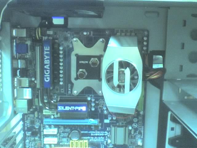

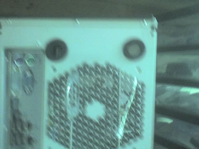

Well I've got good news and bad news. My case is fully modded and ready for my watercooling setup, but the mounting brackets for the MCW60-R gpu block don't fit. I've emailed Gabe @ Swiftech, but I'm still a bit tweaked about all this. Anyway here's some pics as I'm on "pause" until I get my part

Nice cut job! Those wires are looking CLEAN!

Bio-Hazard wrote:Your MCW60 should be a direct bolt-on to your video card unless you're upgrading to a 200 Nvidia series, then you'll need Swifties GTX adapter.
As you can see in this slightly fuzzy cell phone shot, the mounting sits directly on the card and yet theres still space between the GPU chip and the block...

That ain't good at all, must have been a bad batch of top brackets or something, have you heard back from Swiftech yet??

Nope, I've been checking my email every few hours here at work, but no response yet.
I took the opportunity to take apart the waterblock and i'm glad i did, i found a bit of free copper hanging around in there. Not to mention the copper itself isn't straight all around the edges. I doubt it will be a performance hit but I'm not sure. I'll edit this post when I'm off work to include a picture of the inside of the GPU waterblock.
