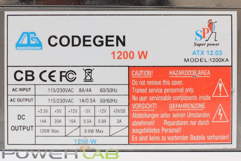

I think so
And the kicker

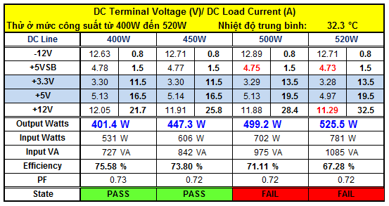

I think their math is a little off, I wouldn't trust that thing over my dell 305W unit from 2003 (which has 2x 20A 12v+ rails!)
Heres a review i think, it's not in english and the codegen site doesn't list any unit above 550w

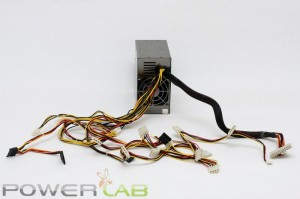

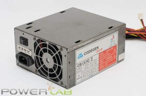

Double typo on their part? Looks almost like 10-15 year old tech in the pic. I remember the Super Power logo from a rig I had 9 years ago.

regardless of what year it is actually from, it's still rated about 900W over what It can actually supply
the most extreme case of over-rating i've ever seen
check it out, can only supply up to ~450W DC or a little over 600W at the wall and the voltage on the rails deteriorate
and looking at the article, dated 5/16/2010 so it's from this year!
