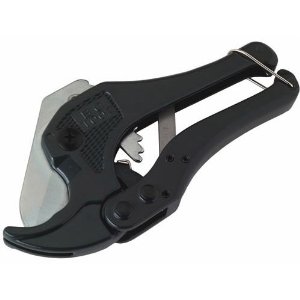

Head to the hardware store and pick up a "PVC Pipe Cutter"
Think I got mine at Lowes for ~$12, best money I've spent on tools in a while. Cuts PVC pipe and just about any hose (that isn't metal re-enforced)
but shows how it works. Nice square cuts.

The cutter in the pic is what I have and it can do up to 2" sch40 pipe, cuts like butter.
