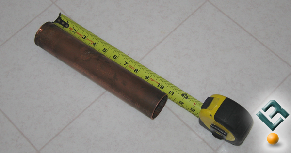

I found what I am going to use for my dry ice tube this morning and the best part of the deal is that it was free. After calling a million places and having no luck for 12 inch sections (unless you want 10 or 20 feet at $15 per foot plus tax) I found this tube in my neighbors garage across the street!
The tube came out of a Schnucks supermarket in St. Louis during a remodel and was originally used as a suction tube for the air conditioning system. So It's a Cerro brand name tube with a Type L rating. It's length is 11.5 inches with an internal diameter of 2 inches...

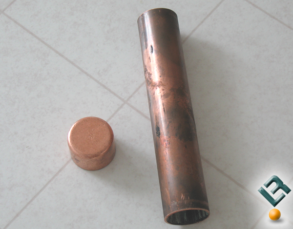

My project has finally started! Now I need to go buy a 2" Type L cap and/or find a think chunk of copper to make the base out of and then braze the two pieces together.... All the supply stores are closed today (Saturday) so I'm stuck for today.

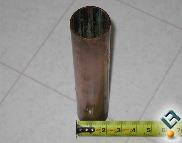

Just in case someone else is trying to do this be sure to get at least Type L pipe as it's thicker. Copper pipe is available in three basic types: Type M is thin-walled, Type L is medium-walled and Type K is thick-walled.
I measured my 2" Type L pipe and using dial caplipers that the outside diameter is 2.125" while the inside appears to be 1.985". I wouldn't make a dry ice tube using Type M pipe as the thicker the pipe the better the results will be. Since it's free I'll be more than happy to use this medium wall 2" pipe, but if you are going to buy some for yourself try to get Type K if you can find it.

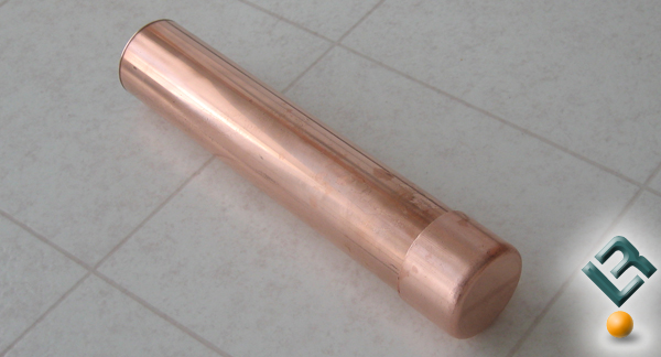

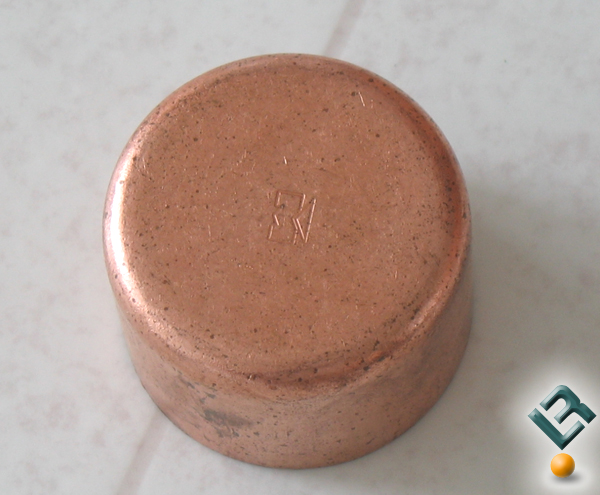

Well I got lucky and found a shop open on a saturday and went and picked up a 2" type L cap for $4.99 at a wholesale plumbing shop.
Man that pipe and cap look a million years old... Look at the surface that is going on the CPU...
Time to take some 600 grit to 2000 grit sandpaper and do some wet sanding on this sucker....
oh yes a mirror finish on the cap bottom and 600 grit on the tube just to give it some bling before it gets wrapped up. I also used a wire brush to clean the junk out of the inside of the pipe. I'm not sure what it is, but I don't want any foreign material in the tube when I add Acetone and dry ice.
I'm now trying to pick between brazing it or using silver solder to secure the cap together. Silver solder would be free as I have the torches and rod here... hmmmm

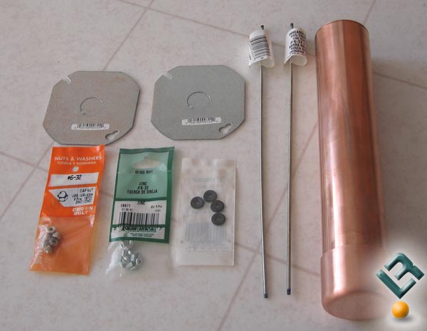

Since my goal was budget dry ice cooling (under $50) I'm going to do the cheapest and simplest thing possible... an Over The Top mounting solution...
Funny you asked that because I just got back from the hardware store (Home Depot) and picked up everything I needed for the mounting system...
This stuff was all cheap too...
2 x #6-32 x 12" All Thread Rod - $0.98
1 x #6-32 Cap Nuts - $0.98
1 x #6-32 Wing Nuts - $0.98
1 x Sealing Washer Bonded (Neoprene) - $0.58
2 x Blank Light Covers - $0.76
Total Mounting Hardware Cost -- $6.02
I also just ordered some 5" x 5" Closed Cell Neoprene Rubber from dangerden to insulate the CPU socket.

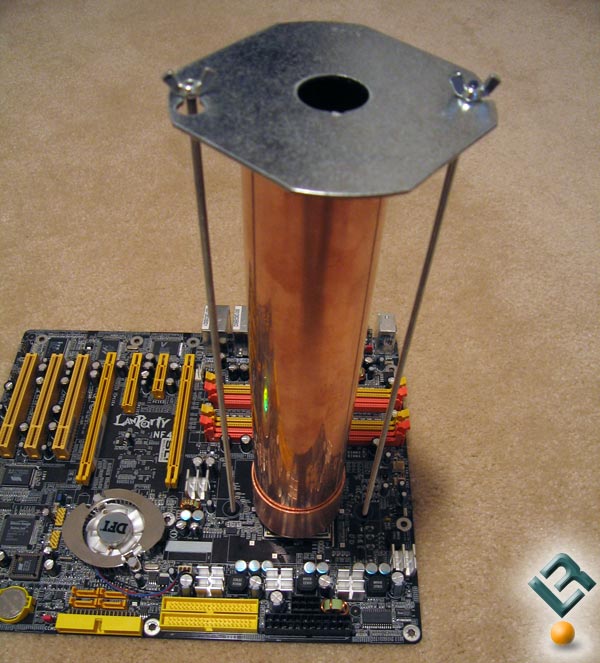

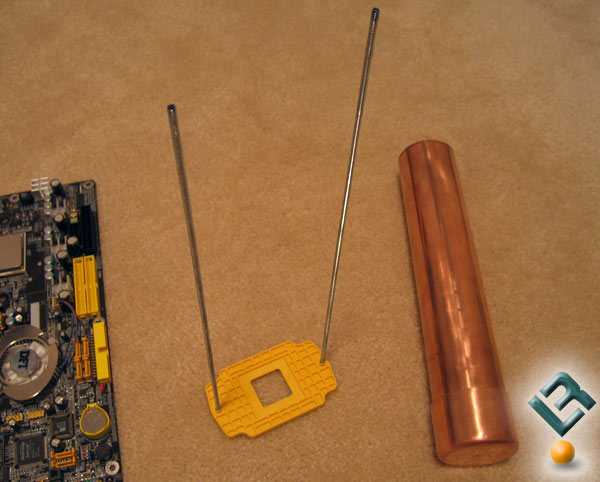

I was using the electric drill to cut the 2" hole out for the top mounting bracket and it started shooting flames out... It was the first tool I bought when I worked at Sears when I was 16... Looks like I'm done on this project for the night!
I did do a test fit though on a DFI 939 board with my FX-60 processor...
and guess what I figured out...
The mounting bracket on the DFI socket 939 motherboard uses #6-32 coarse threads, so my all thread rods screw right in them... forget the nut caps, washers, and other block off plate as they are not needed and this mounting bracket is already solid.
As for removing the IHS I'm not going to do that and I honestly don't know what system I'm going to run this on... It's either going to be on an old Pressler or an old AMD 939 processor as I can't afford to lose a Conroe or AM2 right now.
All i need to do now is drill a bigger hole in the top plate, braze the cap to the tube, and insulate my tube! I'm half way there!
