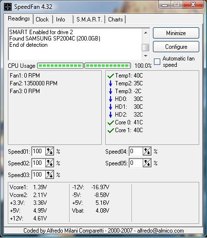

Well I am attaching a pic of the voltages from speedfan on this dual core e6600 overclocked to 3.2ghz with BIOS auto determining the voltages. This has the Ultra X Connect 2 550 watt power supply that I won on here :) - http://forums.legitreviews.com/viewtopic.php?t=7353
These voltages seem to be WAY off. I started looking around when F@H started to end work units early from errors, so I was looking for instability on my overclock when I found these voltages.
Any advise will be greatly appreciated like always!!

Have you tried any other system monitor?
I definitely would!
If you have another PSU switch them and see what happens with your voltages. Your +12V rail is ridiculously low!

Software voltage readings are notoriously off. Get a multimeter, and check them that way. Hell my 12V according to speedfan was like 9.88, and in reality its 12.05 steady

What other system monitor program should I try?
I have a multimeter :mrgreen: no clue what to hit with the little red and black rods though :rolleyes:
I was thinking red to the red and black to the black, but since these cables are all silver, it kinda makes it difficult!
I guess the cable layout is the same as all the rest...Yellow-Black-Black-Red....
Will test if you can help me figure out where to probe!
Mike

Yes it will follow the same layout, the two middle cables are ground (black), you use the black probe on any one of these. The outside cables will be +12v (yellow) & +5v (red). You use the red probe on the multi on these.
You can check the 3v line via the ATX power connector, it's the orange cable and you can attach the black (ground) probe to ANY ground cable (black) on the psu when taking a reading.
