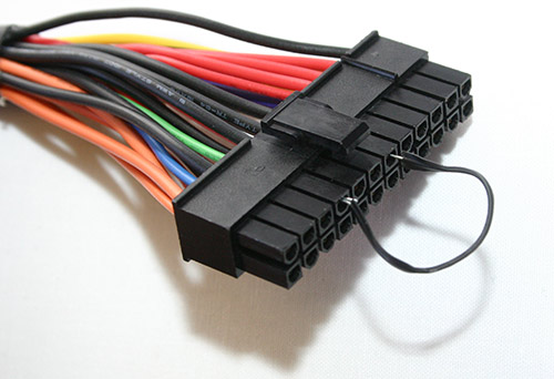

With your PSU off and everything but your pump unplugged (provided that your pump is ready with water to pump), use a paperclip or similar and short a green and black wire on the 20/24 pin atx connector. Turn back on your PSU and it will be on. If its unloaded, i.e. no pump then don't have it on for more than a couple of seconds. But with the pump, and maybe a fan for 'extra load' you will be fine.

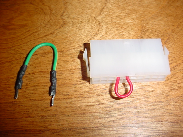

I use a old AT PSU when draining and flushing a loop, makes life so much easier that way, but if you have to just the one you have, be careful and just jump the green and any of the black wires together...............
And a pic of a few simple to make tools for safer jumping.
