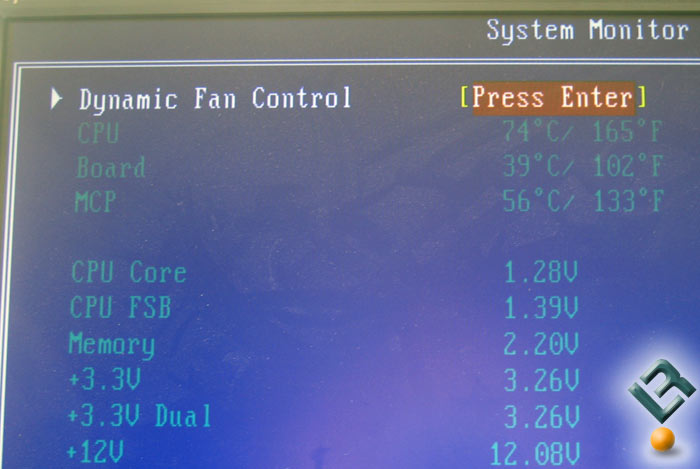

Well I was just sitting in my living room and editing pictures for an article on my laptop when I kept hearing a beeping noise.. Turns out it was the system post beep on my desktop system. I removed the door and went right for the CoolIt Eliminator and was so hot I couldn't touch it. I hit delete to enter the BIOS and the temperature was over 80C!!!!!!! By the time I grabbed my camera and compact flash card from the living room it was down to 74C and that is where I took the picture at. The blinds were open and the Eliminator was set to medium... I guess the sun on the case was too much for it to handle with the system at just an idle...

Re: CoolIT Eliminator
Happy F'n weekend to me... The Intel Core 2 QX6700 is dead.... My $950 processor is fried to **** cause of this cooler... I'm not happy at all
I just went and worked out at the gym with Justin and have cooled down a bit... I'm going to let it sit overnight and tear it down tomorrow and test everything to see what all is bad and good and see what happened. I also e-mailed the CEO of CoolIt Systems and am awaiting a response. Three strikes and your out and it seems this one is a strike out... It works great for a few days and since a number of review sites test out their samples and ebay it before they post their review they never do long term testing. In our case we left it running 24/7 and found out that the Eliminator doesn't seem to be able to handle non-stop use.
Wow, this is surprising considering you received an Eliminator from the CEO himself. Perhaps you are right about the stress testing as it reveals how durable the product is. My friend has a QX6700 but he uses the Freezone and has no problems (except for minor coolant leakage on the cpu block). How come you don't run it on HIGH if you have it on 24/7? I'm beginning to think that the Eliminator was not built to handle quad core cpus. Although, I think you could run a Q6600 with an Eliminator. Most of the people I've seen use Freezone/WC or more advanced cooling with their quad core setups.
Well I talked to Geoff (the CEO) via e-mail and he's going to be looking into this again for me... poor guy has done this a few times with me and tells me everytime it's just me.respek wrote:Wow, this is surprising considering you received an Eliminator from the CEO himself. Perhaps you are right about the stress testing as it reveals how durable the product is. My friend has a QX6700 but he uses the Freezone and has no problems (except for minor coolant leakage on the cpu block). How come you don't run it on HIGH if you have it on 24/7? I'm beginning to think that the Eliminator was not built to handle quad core cpus. Although, I think you could run a Q6600 with an Eliminator. Most of the people I've seen use Freezone/WC or more advanced cooling with their quad core setups.
I agree with you respek that quad-cores are too much for the Eliminator.
Here is a quote from the CEO just today...
Sadly I didn't see any warnings on the box or their product page not to cool one with it as it has just this:when did you put the unit on a 6700? That's a bit tough for an Elim to keep up with...
