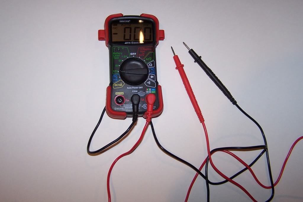

how can i use this multimeter to check the PSU?(what wires to check and what their voltages should be)

Connect the black lead to one of the black slots in the end of a molex connector and the red lead in either the red or yellow slot on a molex connector of your PSU to test the 5V or 12V rails.
To test the 3.3V rails put the red lead into the one of the orange slots on the 24-pin power connector.
