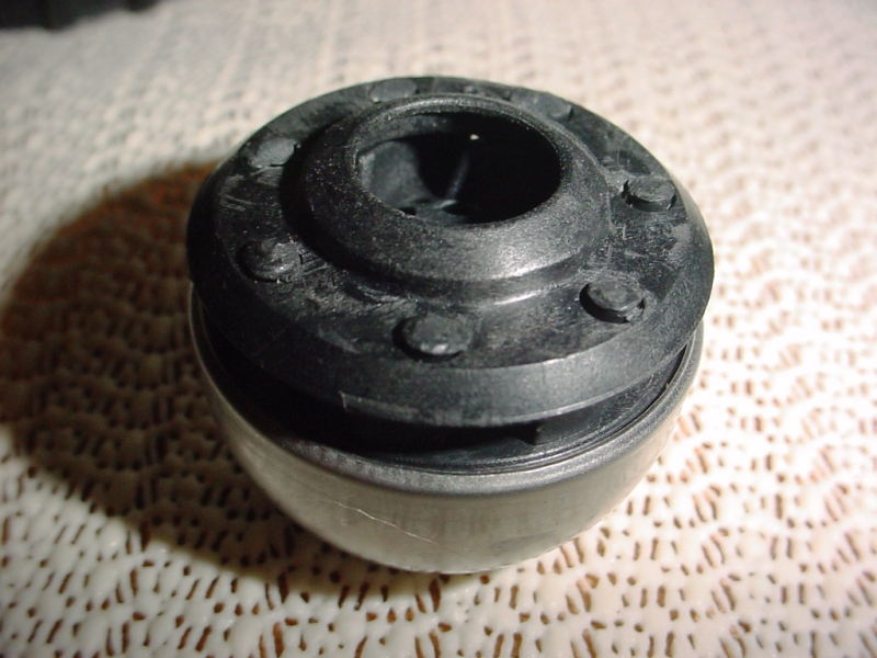

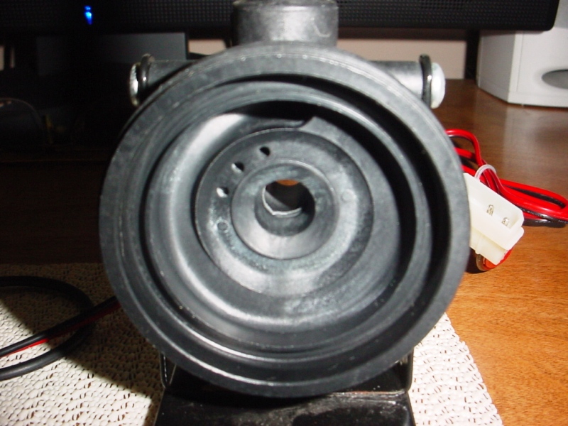

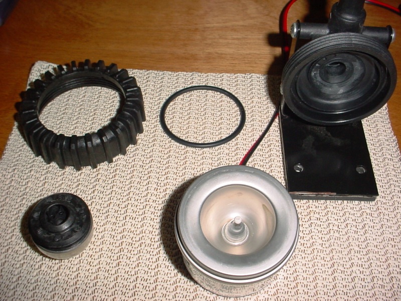

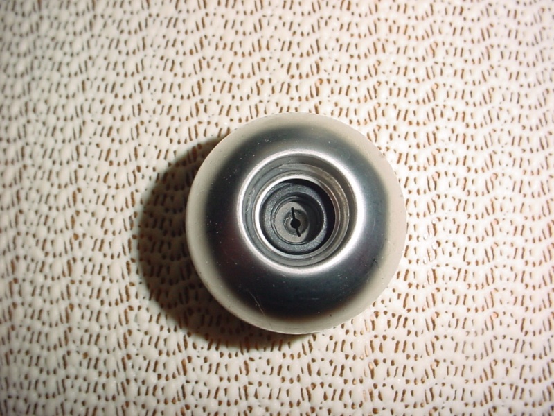

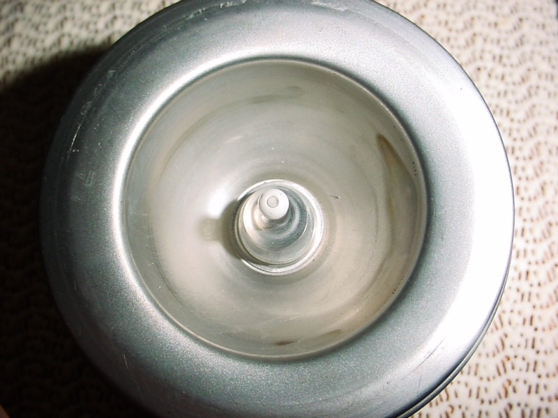

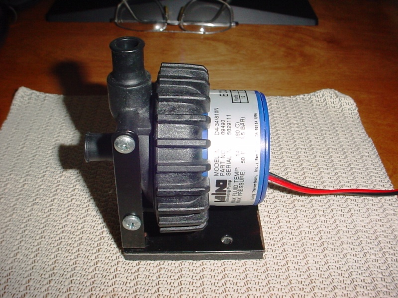

Re: Whiny Swiftech MCP655 (aka Liang D5)
Pull it apart, clean and inspect the impeller area, the impeller rotates on a single ceramic bearing and if that's damaged, you might beable to get away with replacing the bearing if nothing else is damaged. If it's inside the motor part (electronics) you'll need to replace at least the motor canister end.
Stev would beable to give you more detailed test info, after all, that's what he does for a living..............
The rest of the pics.
