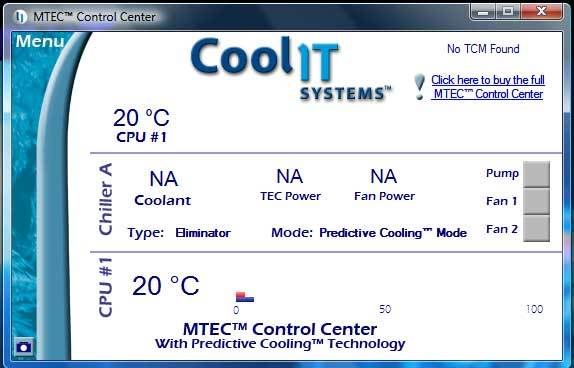

I got my second Eliminator yesterday and it performs like crap. My first one made a lot of noise, caused by air trapped in the pump. The one I have now is more quiet, but just like the first one, cools like ****.
Yeah, I know, I forgot to paint on the load screenie.
These temps are way to high, while the fans runs at HIGH speed.
My e6600 now runs back at stock and the idle temp at medium = 40 degrees celcius and the load temp = 50 degrees
Those temps are to high I guess, judging to what I have seen in the reviews.
I have the D1-1004 with the date code 15-07, so that is April. I have the 2pin plug. Already mounted the unit twice, first with the standard dark grey thermal grease, and the second time with Arctic Ceramique, no difference in temperature. Coolit doesn't respond very quickly through mail

Re: CoolIT Eliminator
My verdict is: don't buy it!
The temps are not as promised, and it makes an awfull lot of noise, well at least mine does.
I will upload a little file containing the noise my Eliminator pump makes.
My screenies were taken @ 3.6Ghz @ 1.5V @ HIGH. Those temps are crazy considering that this are the temps it should get:
My room temp is now 20.7 degrees Celcius and my Idle temp is now 47 degrees
Stressed I now get around 66 degrees stressed. When looking at the screenshot from the 3dhardwareman review that means that an increase of 400Mhz and a decrease of 0.03V will raise the temps with almost 30 degrees stressed and 20 degrees Idle. I dont believe that.
I live in the Netherlands and the shop said that only the new revisions have been sold in Europe, not the old faulty ones.
Still my Eliminator doesn't cool as good as it should, my ThermalTake BigTyphoon performs almost the same, IDLE 45 stressed 70. WOW, a 3/4 degree drop for only 182€.
I'm going to RMA this product again, hopefully I will figure a way out to get my money back and else I will sell my replacement unit for around 170€ (shipping cost included)
Edit: this is the sound file: http://home.wanadoo.nl/fam.tilstra/pump.mp3

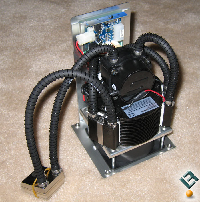

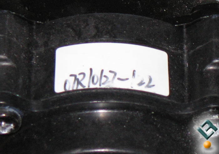

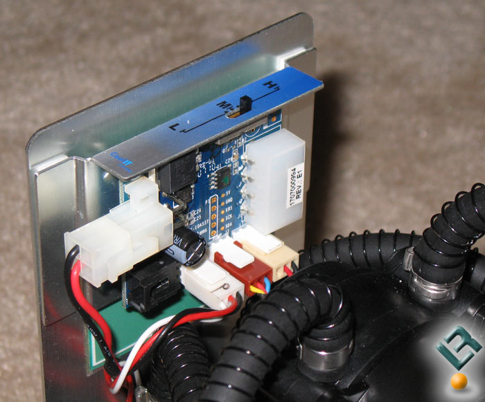

your water pump is bad and you need to RMA it... Mine also went bad and just today I got in my new unit... The noises in the above post are identical to what my unit did and if you unplug the water pump it stops...
Old Date Code - 0507
New Date Code - 1507
Below are pictures of the old and new units... The original one I got (Date Code 0507) had a label on the pump and I posted it below.
- Attachments
- The label on back of the water pump after the pump was removed
- eliminator_replacement2.jpg (48.19 KiB) Viewed 14041 times
- the old and new models... Same PCB on the speed selector
- eliminator_replacement.jpg (117.54 KiB) Viewed 14038 times

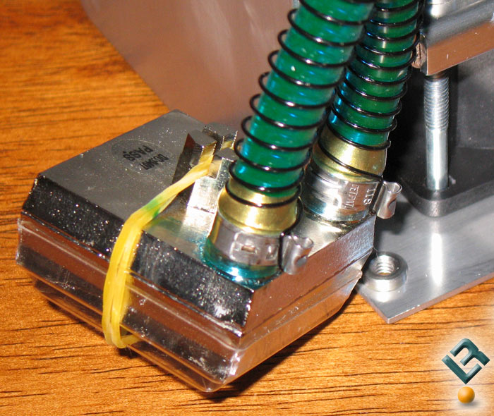

well crap... just noticed my finger was blue...
If you look at the above picture you'll notice the new one (the one with the rubberband still on it) is leaking coolant out of one of the cooling tubes...
Both of the retainers can be moved with my fingers on the new model, while on the old one they couldn't be twisted... Quality Control needs a good smack in the face for this one.
It's not a bad leak, but WTF
- Attachments
- WTF - Coolant leaking out on the replacement
- eliminator_replacement3.jpg (109.84 KiB) Viewed 14023 times

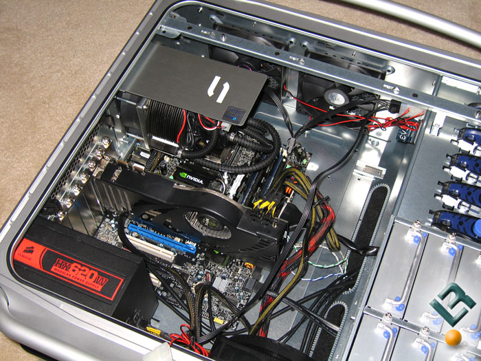

Well after talking to the CEO of CoolIT about the problems on the replacement unit they sent me out a third one and this one was said to be tested by him personally and is the lastest and greatest revision of everything. This one has all black hoses and water blocks as they have recently moved to Norprene tubing. Norprene will not weaken or crack following years of exposure to heat and ozone, so this tubing should last longer.
This model also has a different control module than the old one as it has a four pin header now...
Original Review Unit Date Code - 0507
First Replacement Date Code - 1507
Second Replacement Date Code - 2607
I hope this will be the last one as it has numerous changes to it according to CoolIt... The major changes are of course the improved tubing, the new impeller in the water pump, and the new power header for the PCB.
oh well... I took the plunge and installed it back in my personal system that is on 24-7....

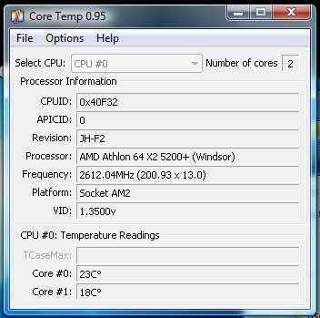

Hi Apoptosis,
Have you tried switching off the two 120mm vents on top of the case? I'm using an eliminator as well, but on an AMD5200+ and a DFI SLI M2. My memory sockets are located at the back of the CPU. So they are located right underneath the eliminator.
I bought an OCZ memory fan. But before I've put them in, my core #0 and core #1 temps are just 20C+/-. Here's a screenshot of my temps before:
but when I installed the OCZ, I saw a huge jump in the two cores, core#0 is stuck at 34C+/- and core#1 is at 28C+/-. I've connected the OCZ to a speed controller and see digit decrease on temps when I lower the fans.
Both temps are taken at high settings, stock speed and on idle.
Ambient where I live (Philippines) is about 32C.
