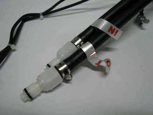

First thing I thought of was the QD fittings, yeah they make life nice getting the system in and out; but it could be restricting flow and who takes the system apart on a regular basis other than someone who does reviews. Well I removed them and was surprised that they were 1/4” fittings.

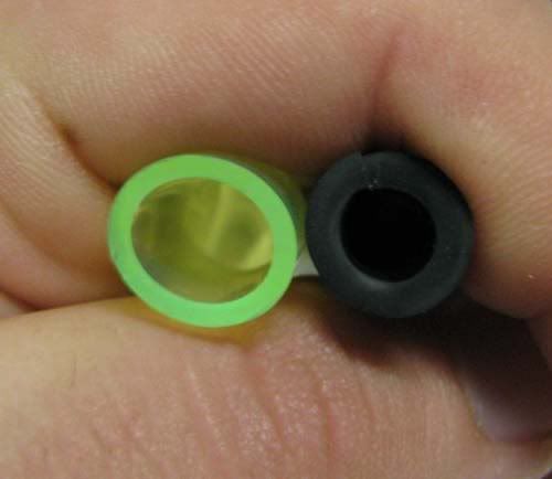

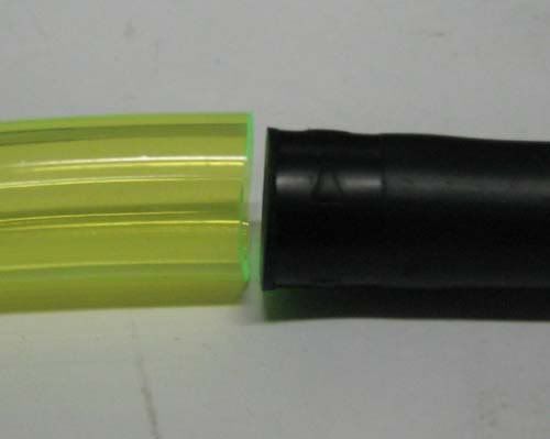

Too look at the tube from the side you would think that it was a thin wall 3/8” ID neoprene tube.
Nope 1/4”, well that can’t be helping things any.

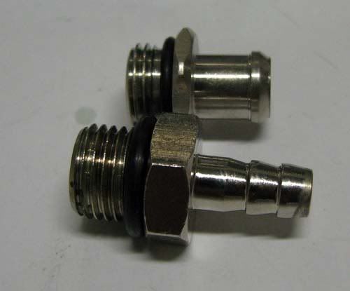

Enter Danger Den 3/8” high flow stubby’s, since the P500 pump has G1/4” ports you have more options than you can shake a stick at. Here is the stubby fitting next to the stock hose barb.
You can see they have a little more throat than the stock fittings. Yes I know its a stubby's are a larger fitting, but you get the point. Actually you can put the stock barb inside the DD fittings. This should help a bit and I'm only out $5+shipping.

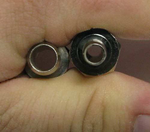

Well I got to thinking of the fittings on the water block. Well the fittings are not G1/4 fittings, not sure what they are, but they are small to say the least. So everything I did above may not help a bit, but I’m learning something in trying. Above is the stock fitting (lower) next to a Koolance 3/8" high flow connector.

get an apogee gt 8) that fitting looks like it has some nasty gunk in it :shock:

martini161 wrote:get an apogee gt 8) that fitting looks like it has some nasty gunk in it :shock:
The 'gunk' is a thread sealer like pipe dope for your home plumbing, and yes it was a pain to clean out.

yeah that plumbing tape is a big one to clean
