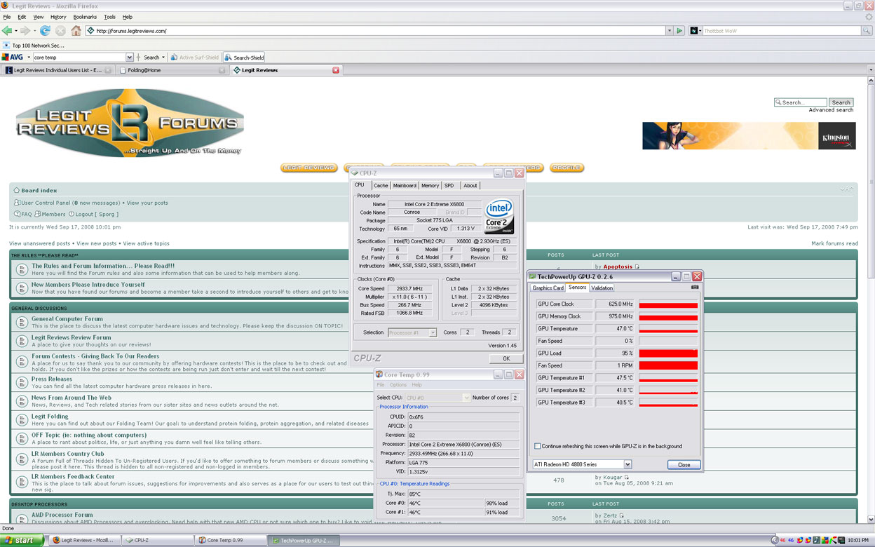

It's actually kind of warm this evening. According to the laser temp gauge that I borrowed it's 85oF in here (that translates to approx. 29.4oC)
I've had F@H running for a little while now on the GPU and CPU. I still have the fans running below 100%. I may move this thing out from under the desk to let more of that hot air escape. I think I'm going to hook up the case fans to my fan controller too. The system is only running them between 500 and 600 rpm and I'm wondering if they aren't moving enough air around in the case. I still need to order that replacement hose, so I may just get a couple of Yate Loons to throw in there and then hook those up to the controller.
~Bertrand Russell

Re: Sporg Watercooling Work Log (56k warning)
Post by DMB2000uk »
16/17 degrees above ambient is a very nice result ^_^

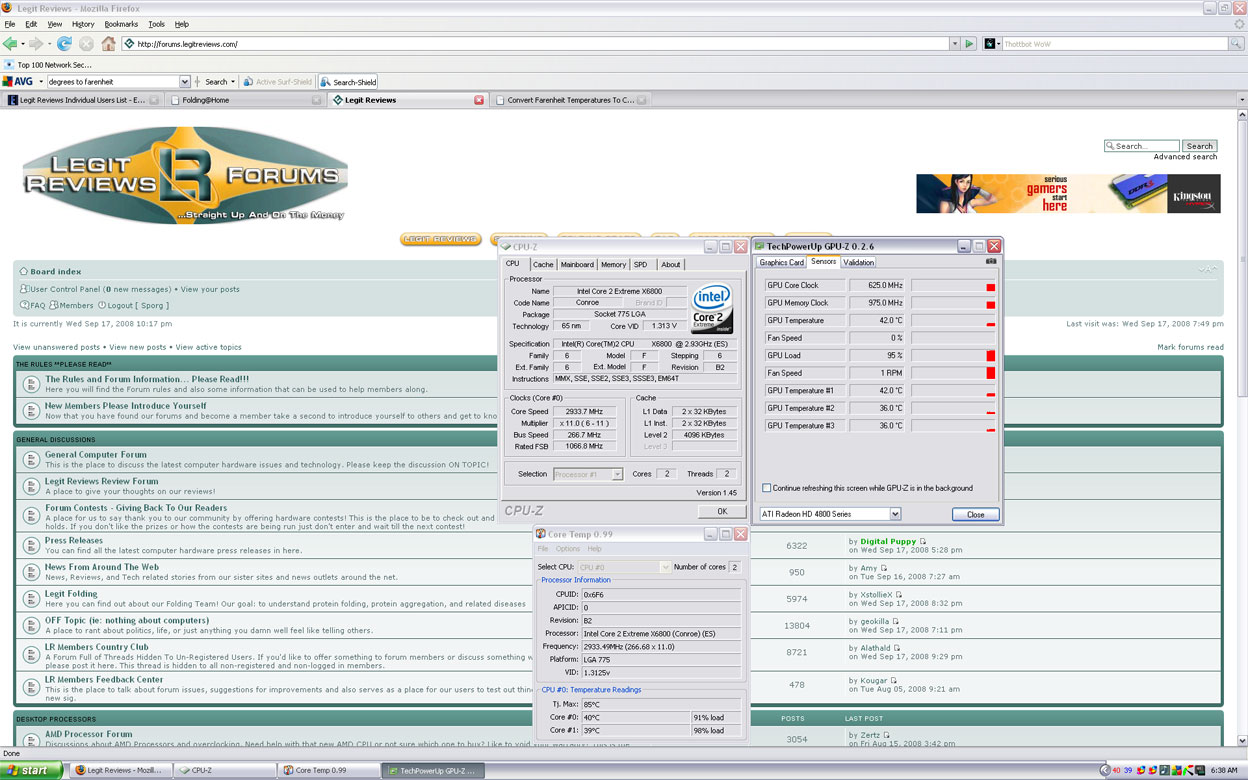

Post by Sporg »
Thanks Dan, I've been pretty darn happy so far with the temps. I haven't let the fans run at 100% to see how low the temps will go. I also might pull out from under the desk to let the air flow better and keep that heat from getting trapped under there. Then again I may just make a heat baffle to put on the underside of the desk.
Took this screenie this morning. Room temp was 75oF (approx 23.89oC). I did find some 'before' screenies that I took. They are in a word doc at home, so I need to convert to jpeg. Will try to post tonight.

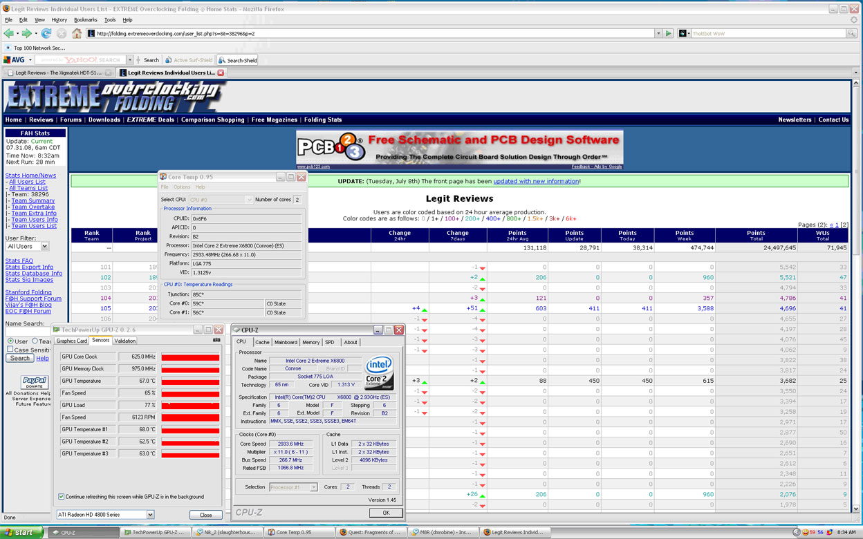

Post by Sporg »
I found a before pic of the temps. I think it was only running F@H GPU client and nothing else really, so keep in mind that the CPU cores weren't really loaded. I think that screenie was taken around mid-summer when we had a ton of heat. I'm not sure what the ambient room temp was either, but those temps were 'normal' at that time. I was also on the 2nd page still, but we've moved on since then. :mrgreen:
