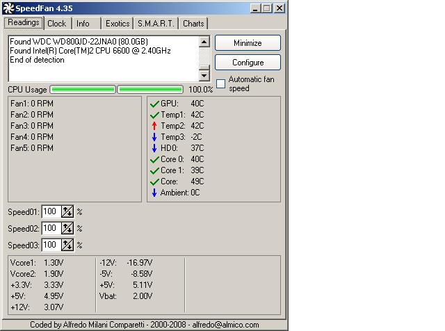

WHAT A PAIN! Its not ALL the big water 735's fault, but it was because I did not have a case for everything to fit! I have the radiator and the pump/reservoir sitting outside the case! One problem WAS the 735's fault - the pump was broke! I took it apart and found the impeller was sitting against the housing because the rod that goes down the middle to hold it up was not attached :( I super glued the black cap to the pole and then to the impeller to hold it up at the height it should be, but it is noisy and I fear will die pretty soon. Hope the computer shuts off if the temp gets to 8000 degrees in a short time period :roll:
Temps are amazing so far!
Stock fan at 100% load
Stock Fan.JPG (44.38 KiB) Viewed 3283 times
Water Cooling at lowest fan speed
Water cooled - lowest fan speed.JPG (43.88 KiB) Viewed 3158 times
Running the fan at 100% now and will update again :)
NOTHING is overclocked on that one. It is an E6600 and a 7600GT video card - nothing earth shattering ;)
I do NOT like how the vga block attached since it is only by 2 corners rather than 4! I just dont like that at all, but being on the 7600GT, I dont care too much if it fries ;)
