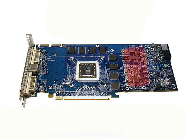

Re: Corsair HX620W and Dual Powercolor 4870's
I've searched and searched and cannot find if the Powercolor uses the ATI refrence board layout. I'm probably going to have to water cool these bad boys and am wondering if the Koolance card cooler would work.
Answered my own question. Here's the response from Koolance for those who are interested.
Koolance wrote: This sounds like the most common conflict between the HD 4870 when it does not work with our VID-487 water block. The original reference layout works fine, but as cards get older, companies often begin using alternate versions of the board. In this case, later 4870 cards have a taller row of caps between the GPU and outside VReg heat sink. Currently, that appears to include cards by Sapphire (100259-1GL in particular, but possibly others), PowerColor, Palit, and now Diamond. We have added these to our product wizard.
EK makes a 4870 block where you can remove thw V-reg section, you might want to take a look at those, but I'm not sure if the mounting holes would line-up or not.

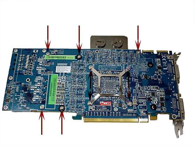

If you're brave, pull your heat sink off and take a look at the position of the components, if they look like the included pic, its a reff card (doesn't matter about the color).Skippman wrote:I've searched and searched and cannot find if the Powercolor uses the ATI refrence board layout. I'm probably going to have to water cool these bad boys and am wondering if the Koolance card cooler would work.
I've actually e-mailed a few companies this weekend about this very issue. I e-mailed Aqua Computer, EK, and of course Gabe @ Swiftech asking who makes solutions for my card. My card appears to look like this without the cooler:
Fortunatly both my cards are identical as Powercolor apparently released two diffrent PBC's for my card. So if I can find a cooler that will work it'll work for both cards. The Koolance might work but it looks like that one Pot is in the way and there might be clearance issues with the copper reinforcing bracket they use.
I'm really hoping that Swiftech cooler works for it as it will clear the bracket, is small, from Swiftech, and is reasonably priced. I don't really want to OC the card, just keep it cool and quiet. That and now I have the water cooling bug.
martini161 wrote:what pot?
Correction, cap. At least I think its a cap. There two of them side by side to the upper right of the memory modules.
