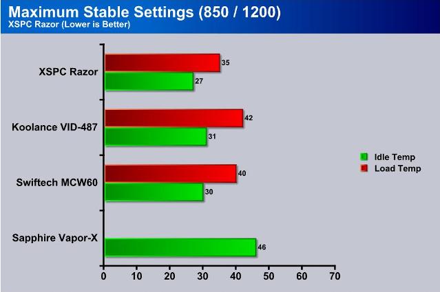

To be honest I did a review of the Koolance and XSPC full coverage blocks against the Swiftech MCW60 a little while back and I got the best overall performance out of the XSPC Razor on my 4870. Along with keeping the GPU and ram lots cooler the full coverage blocks keep the voltage regs alot cooler resulting in more stable OC's on the cards. those "V" Regs get extremely hot under load don't you know.
- Attachments
- RivaOC1.jpg (26.23 KiB) Viewed 12810 times
