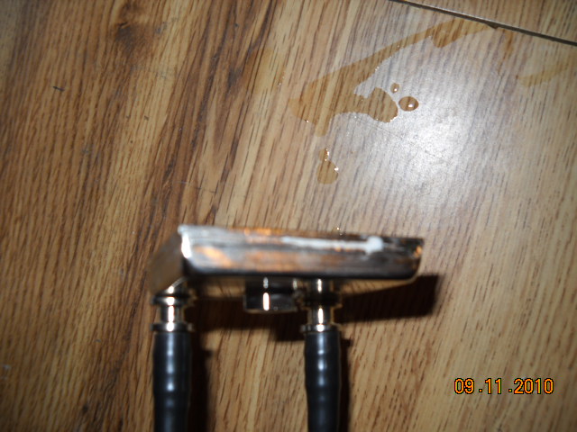

I know this is an old thread (came across it while researching "Domino Leaks"); but I thought I would add my 2 cents in as well.
I've had my Domino for almost a year without any problems...how wrong I was!
The unit had been leaking from the waterblock itself (I had to look real close to find the leaks), the leaks was almost unnoticeable...long story short, it fried not just my motherboard, but the CPU and video card as well.
I contacted CoolIt early this morning; got the usual replies from them (copy of invoice, pics...the usual), and am now waiting to hear what comes next (if anything).
I've heard back from the etailer I shop at (they've been servicing my system for years), the motherboard is definitely shot, they don't carry AM2 boards anymore...AND because the frying was due to the water damage, it's not covered by the warranty.
Pic included is of the waterblock leak...almost need a magnifying glass to see it
Can life get any better ](*,)
