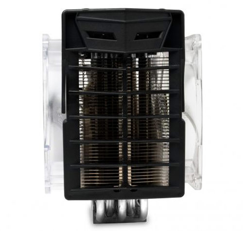

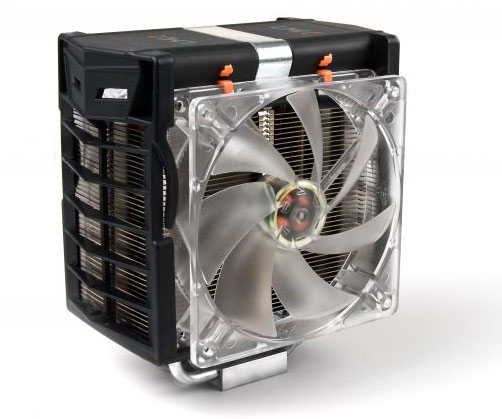

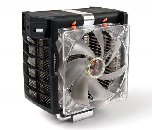

Danamics is proud to present their all new liquid metal based CPU cooler, Danamics LMX.
Danamics LMX specification
Product name Danamics LMX
Heat-sink material Nickel-plated aluminium
Tubing material Nickel-plated copper
Housing material Plastic
RoHS Compliant Yes
Dimensions (LxHxD) 158.2 x 170.5 x 90mm (heat sink only)
Motherboard clearance height 30mm
Weight 1180g (heat sink only)
Processors supported All AMD(TM) processors for Socket AM2/AM2+/AM3
All Intel® processors for Socket 775/1156/1366
Ambient operating temperature range 0°C to 45°C
Liquid Metal type: Sodium Potassium (NaK)
Electromagnetic pump specification
Power consumption Less than 1W
Magnet type Neodymium Block Magnet
Gauss Rating, 0.05m, xyz axis 12 Gauss (0.0012 Tesla)
Fan-compatibility 120mm fan with 25mm thickness
Fan specification
Dimensions (LxHxD) 120 x 120 x 25mm
Speed 2000 rpm
Airflow 75.7 CFM
Noise Level, 1m, x y z axes - average 21.8dBa
Noise Level, 1m, z axis 28.6dBa
Operating Voltage 6.0 - 14.0V
Current draw 0.30A
Power consumption 3.6W
Bearings FDB, Fluid Dynamics Bearings
