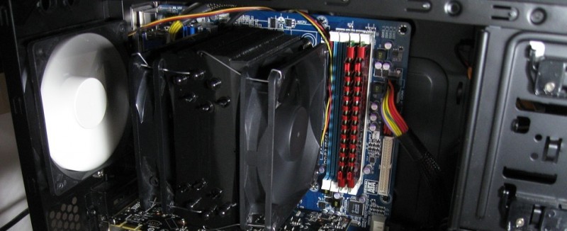

Got the AM3 bracketry and some new compound from frozencpu
how it looked after initial paint mmmmmmm getting excited now
after dry 2,000 grit - stopped once there was an even amount untouched on all 4 corners as any CPU will be more than covered by what i have already finished
sandpaper used (10 sheets of that 150grit were used, one sheet of the rest, 'get a clean sheet-> rotate and sand with same used sheet->rotate for next grit' -only rotating once the previous round's scratch marks are gone)
skier wrote:Got the AM3 bracketry and some new compound from frozencpu
/img
/img
/img
WOW! look at that base shine!!
