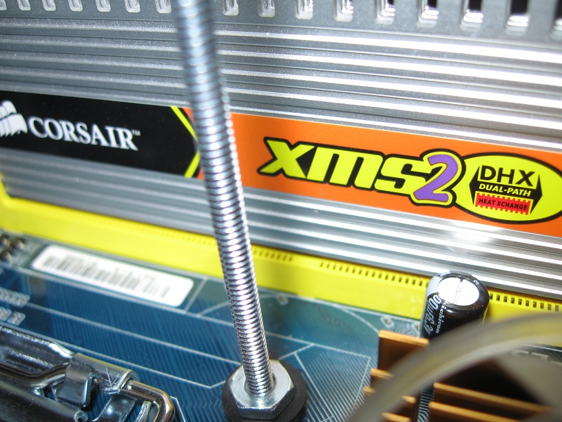

the pipe has a 2"ID, 1/16" thick with a cap brazed on, I'm in the process of making a mount for it
got that nice chunk of copper with the pot so that the chilled alcohol can transfer temp to it, which will allow the pot to cool the CPU for longer without having to use more DICE (ie, give it more mass). the piece of MDF there is an early pic of my trial mount, the corners of the square mark LGA775 mounting holes
you can tell why it is a 'trial' mount

mmm fits nicely, notice the AM3 mount holes :D

cutting board from walmart: $2.97 = 1x 775, AM3, 1156, and 1366 socket backplates, with leftover.
finally got the pot off! :D
i'd say it made decent contact
