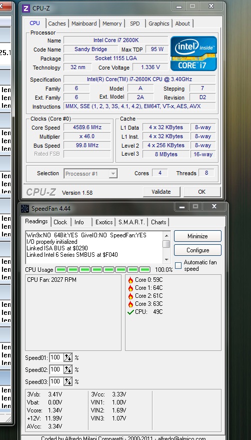

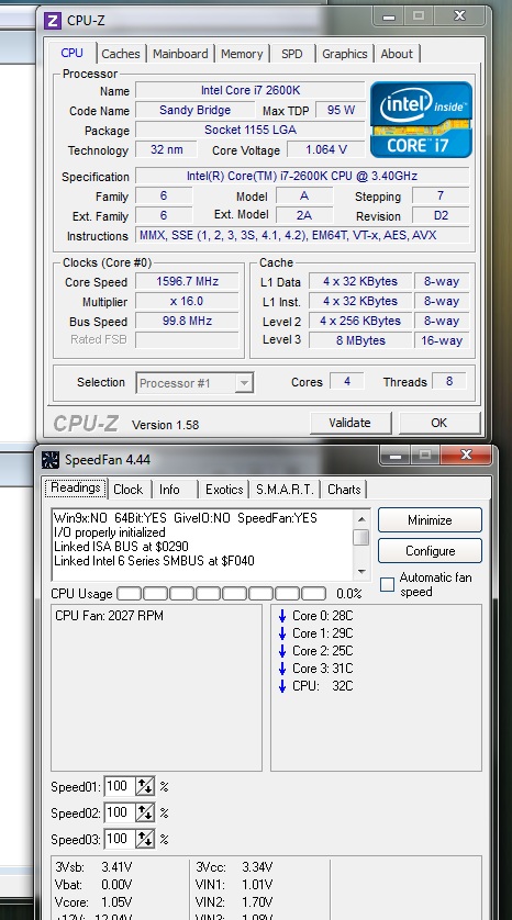

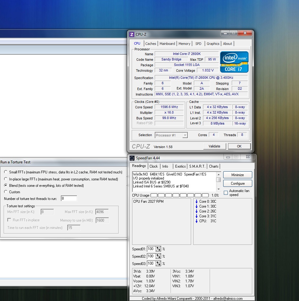

Recently got one of these for my Rig upgrade to Sandybridge. Took some pics but they came out horrible so screen caps will have to do. Rig used in in the signature.

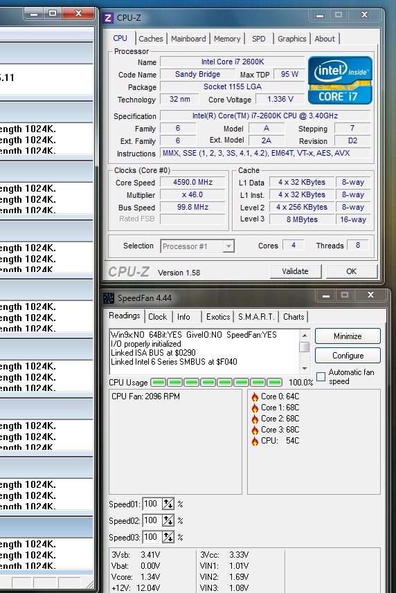

Test runs with Prime95 In-place large FFT:
Idle mode - Quiet:
Load mode - Quiet:
Idle mode - Performance:

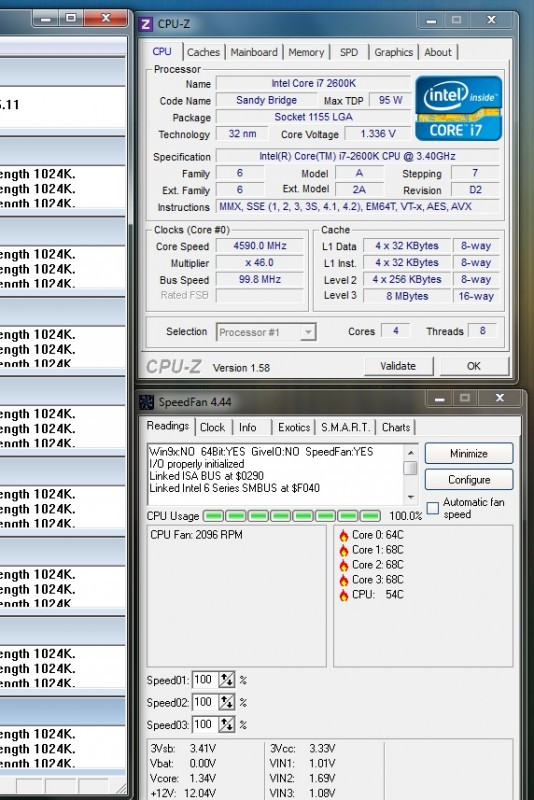

Load mode - Performance:
While there is a considerable difference in temps between Quiet and Performance (and Balanced is right in the middle) it does come at a distinct cost to the ears (not horrible but not pleasant if you like quiet).
I have opted for Quiet mode with a 4.6 ghz overclock for day to day use. This cooler has plenty of headroom!
