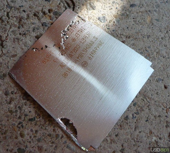

The pea size dot works for thin pastes, thicker ones like the GC Extreme you need to butter the CPU with the card method.
Too much is as bad, if not worse, as not enough. Too much it can ooze out the side making a real mess, compounded if its conductive. Best bet is to apply as directed by the brand maker, seat the cooler, and pull it to see how the spread is.
The Indigo is a liquid metal, not really a paste, end up with a custom fit thermal shim basically. There is a bit of a process to get it installed, not like paste that is a "squirt and run" thus the exotic label. Some have reported over 5*C lower temps over most pastes.
Here is a shot of indigo pulled off a chip after installing.
Not my image, from http://translate.google.com/translate?j ... l=ro&tl=en

by Skippman
Wow!! That's crazy! I guess the bubbles are from where there wasn't enough of the compound on the proc at the time. Looks like it pulled the ink right of the processor die!
Re: Thermal Grease
Posted: Tue Dec 20, 2011 2:43 pm
by bubba
Not ink, laser etch.
