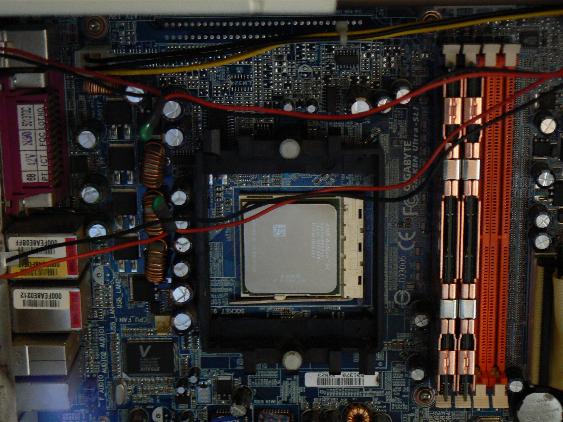

Here are the pics!!
Mike
If you have one, let me know a cost so I can get back to you!
Piece I need
Piece I need
Motherboard Hold Down Clip Thing 003.jpg (52.5 KiB) Viewed 15147 times

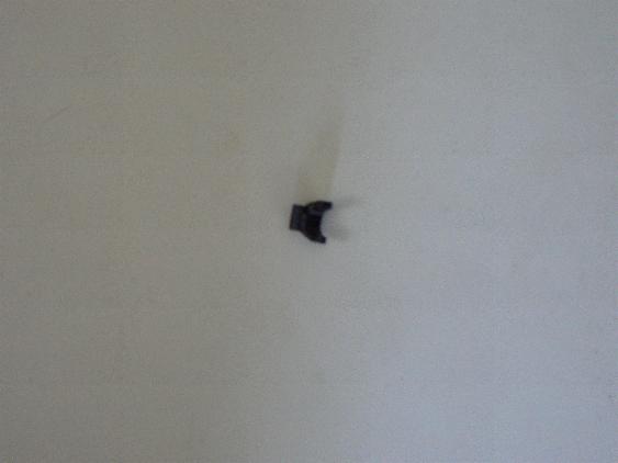

Piece that broke off and landed between the heatsink and cpu
Motherboard Hold Down Clip Thing 001.jpg (13.63 KiB) Viewed 15115 times
kenc51
Posts: 5167
Post by kenc51 »
Mike,
That's just the plastic bracket.......I have a few of those here, I can send you one if you wish? It's only a piece of plastic so should only cost a few euro to post over.
Ken

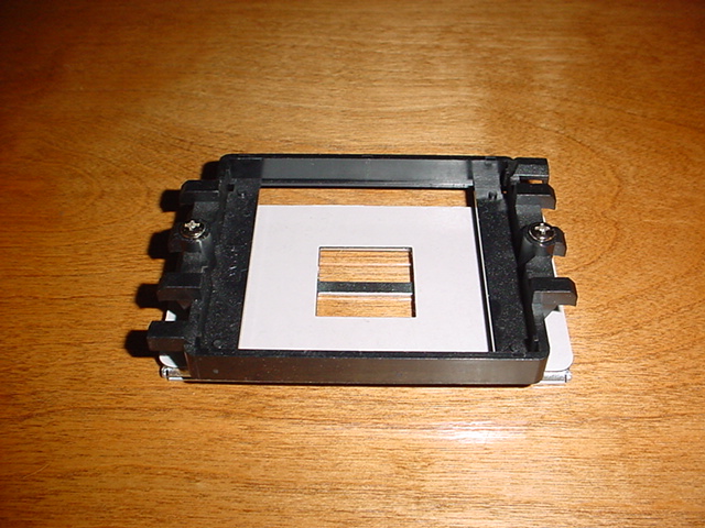

This is what I'm sending you............ :shock: I'm including a metal back plate and screws just in case.
