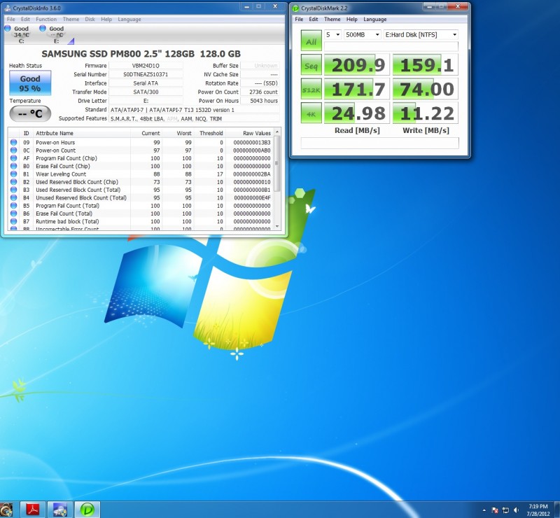

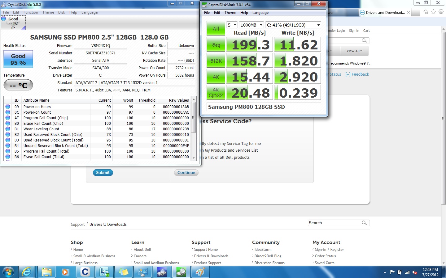

I got a laptop from work, and it has an i5 2.4, 4GB RAM, and was running slower than ell when I got it, so i figured okay, might as well get an 8GB kit of faster RAM, so i proceeded to do all in my power to speed up the machine, and ran CCleaner, and defraggler. at this point I found out that the PC had a SSD because defraggler threw a warning, so i ran crystal disk info to see if it way okay, and showed fine, so I ran CrystalDiskMark to see what transfer speeds I was getting, then I saw the issue:

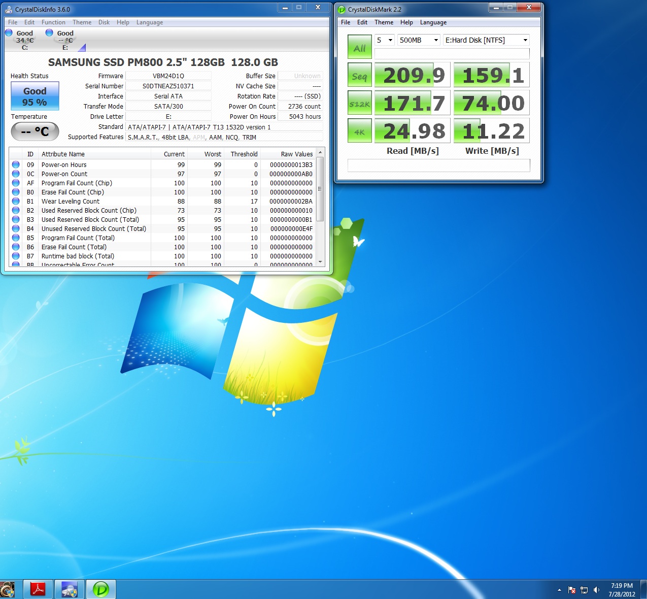

and yes i got roughly the same result after running it again, apparently 5 other users had been set up on the laptop before me, so i decided a firmware update was certainly in order, otherwise the drive is toast, so i pulled it and formatted and ran the test again from my desktop at home since i'd have to wipe it to update fw anyway:
o.0 pretty big difference with a format, now lets see after FW update:

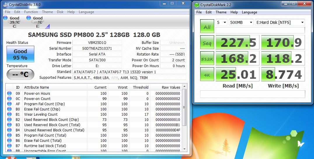

long story short:
SSDs require some extra work to stay peppy

why did you start out using CDM 3.0.1 and then switch to CDM 2.2. I don't think the scores are comparable.
Also, keep in mind the original firmware didn't support TRIM and Samsung later released TRIM supporting firmware. So you are seeing the impact that TRIM has on drives as well to keep them running in an optimal state! The Samsung PM800 with TRIM is a solid drive, but the original drive without the TRIM FW is slow over time as you saw.
Re: Ladies and Gents
the first test was run at work, and the second at my apt, i didnt want to download it again as i had the old version on my storage drive already.Apoptosis wrote:why did you start out using CDM 3.0.1 and then switch to CDM 2.2. I don't think the scores are comparable.
and I checked before i did anything that the TRIM flag was set (and you can see it set in CDI). it already was. unless the OS would say enabled regardless of whether the drive is supported

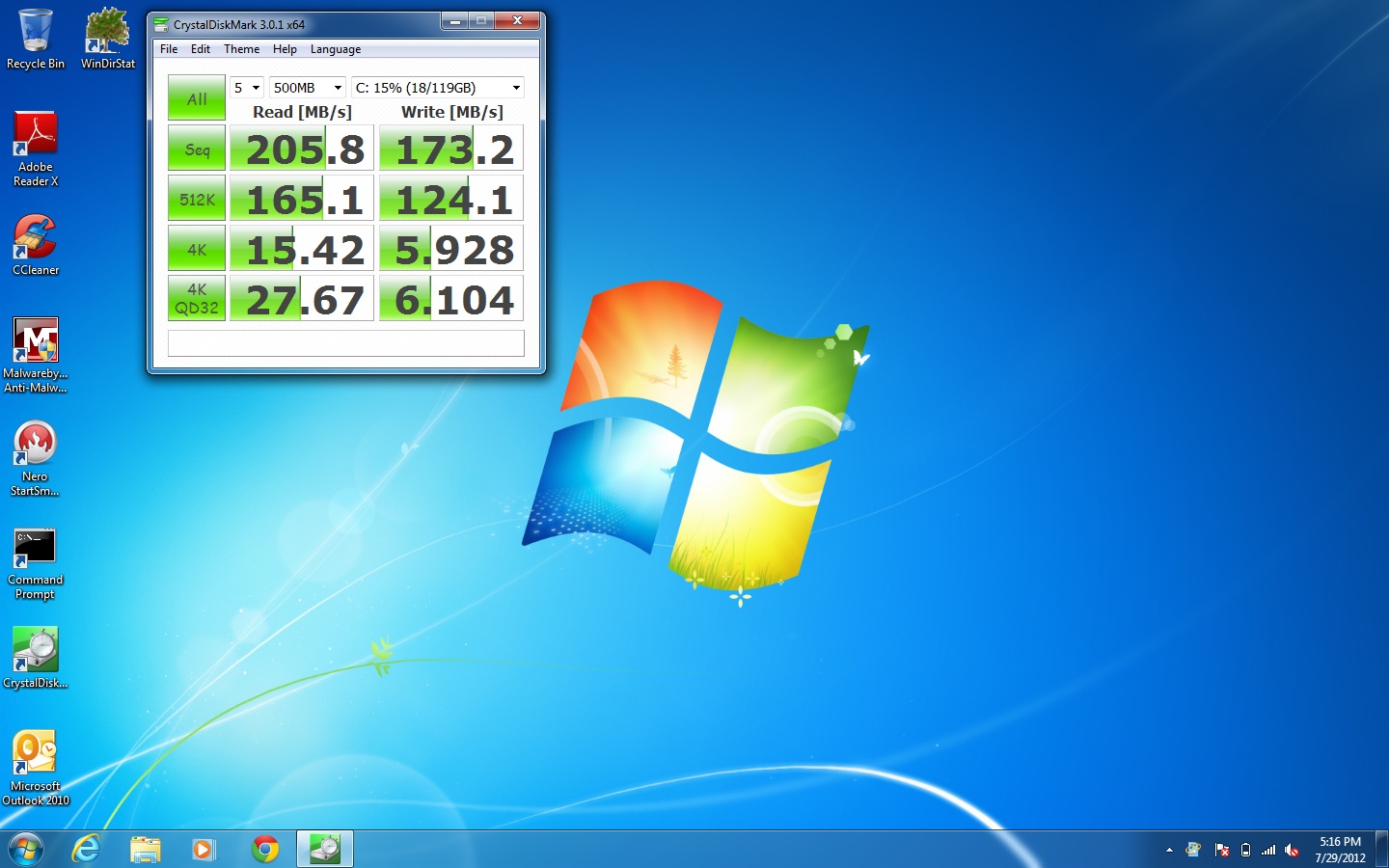

edit: ran it again after installing win7 ent, office 2010 pro plus, and all windows updates, with pagefile and hibernation disabled:
I would say its a bit snappier
