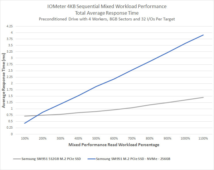

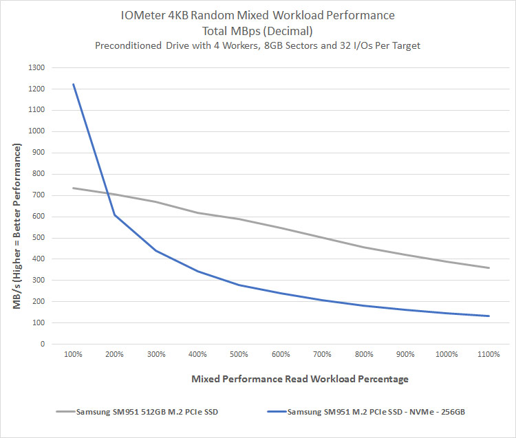

I am also noticing lower than expected 4KB performance at a QD of 32... The SM951 results are not anything close to what I expected and I don't have any good answers for you.
I've been working with Samsung trying to get answers, but I've been waiting on answers to what I would think are fairly simple questions for more than a week. It appears that these OEM drives are not a priority to them even though they are getting a cult following among enthusiasts.
The SM951 AHCI 512GB drive is tested after a Secure Erase and the SM951 NVMe 256GB drive has not been secure erased as there is no easy utility out there that can do it and my Linux kung fu is weak although I know there is a way to do it under Linux.
When I made these charts just for you I messed up the bottom axis. It should be 100% to 0% not 100% to 1100%
