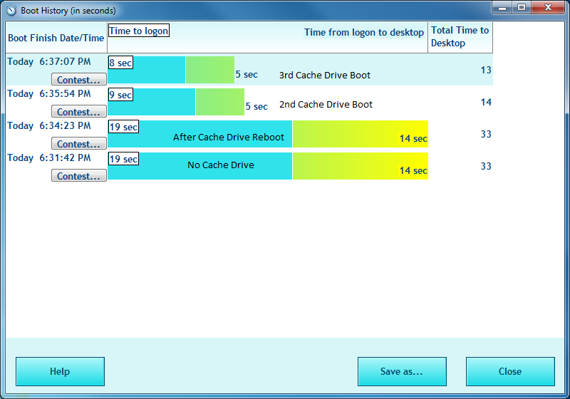

Ran BootRacer and it confirmed my 5 minute suspicion...

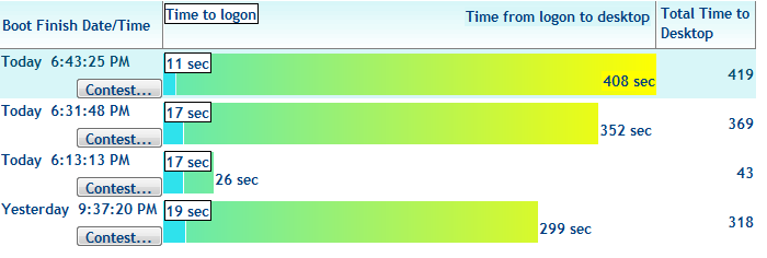

Ok got the drive installed along with the PCIe 1X USB 3.0 card I ordered. So far I'm getting really annoyed. Nothing is working like I hoped it would. The USB card is transferring slower than the onboard USB 2.0 ports did.
Then to top it off the boot times have gotten worse. The only thing that's interesting is after installing the cache drive and USB card the computer booted fine (under a minute). Installed the cache software rebooted and it took over 6 minutes. Ideas?

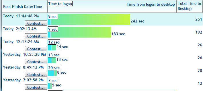

Appears too that the boot times are constantly getting worse.

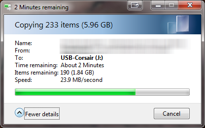

I'm starting to think this has to do with PCIe lanes. When I attached my USB 3.0 drive to the card my PCIe WiFi card would drop the connection. So I just tried to reboot after pulling the USB 3.0 card and disconnecting the DVD burner. Only things attached now are the 2 hard drives and the video card. Small improvement but it still sucks.

I installed the new USB 3.0 card in my main machine to see if it was faulty. In short, no it's not. So now I'm contemplating reinstalling Windows but I really don't want to do that with the number of applications I have installed. I have noticed that programs are a lot snappier to open, though they aren't nearly as quick as a stand alone SSD. If I had to sum up the performance gain I'd say it's comparable to when I had two of these Samsung Spinpoint F1s in RAID 0.
USB Results - click to enlarge.

Another small update. Just uninstalled a bunch of stuff I wasn't using. Ran some registry cleaners and that didn't help one iota.

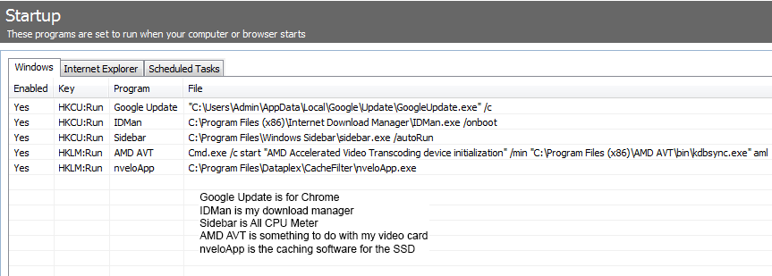

GO into your MSconfig and shut off the programs that are starting up. Uncheck the boxes, also make sure you don't have any programs doing that automatic updating crap.
Run>msconfig>start up> uncheck everything you don't want to start up with computer (do everything but your video card drivers)>click ok>no you do not wish to restart/ poof you done
All this does is stop programs from starting up, nothing else. some messenger virus scanners may need to be set up manually through those programs.

Kill everything out of your startup, and do a reboot. It *should* be back to the quick speed. Then re-enable startup processes one at a time until you find the offender. It may not be a single process causing the issue, but a combination of them as well so if you think you have found the offender, disable everything and only enable that one. I have seen some absolutely horrific performance problems caused by two programs just not liking each other and causing the system to lock until windows automatically kills the process/service. The boot times you are describing sound similar, microsoft likes to use 300 seconds as the default timeout on a lot of things.
Once you find the offending software/combination of things you can decide what to nuke from there. Most software packages that have a startup element dont actually need it to run, though you probably already know this.

I've already done all of those things and more (disabled a ton of Windows services too). The issue is with a piece of software but at this point I don't know which one, I still suspect some damn .NET Framework install.

egloeckle wrote:I really hope I am replying on the live server to this....
Did disabling all startup programs and non-essential services make a difference? Make sure you disable non-essential microsoft ones as well including the .net NGEN services.
If doing that does not make a difference, the problem is a much larger PITA and is a driver being loaded into the system. Any odd devices buried anywhere in device manager that may have been added by some software? I doubt it will be that easy, but it is a good place to start.
I did try setting the NGEN services to manual but it didn't help. It could be a driver issue. My internet has been down most of the time for the last 3 days and I was finally able to download the Catalyst drivers. Seems like those were the last drivers I installed before all this started happening.
DragonFury wrote:I never had an issue with .net did you go into the Msconfig? Hmm I will have to think on this a bit more. that does not look like msconfig on any windows I messed with.
That's the Startup tab for CCleaner, same thing as MSConfig. Only with CCleaner you can delete entries instead of just turning them off.
kenc51 wrote:Try disconnecting the SSD, boot off the mechanical disk and run a thorough defrag
The drive shouldn't be fragmented. I installed Windows Saturday evening. But I'll give it a shot. You think I need to disable the cache drive to defrag the mechanical drive?
Thanks for all the help and suggestions. Keep them coming.
