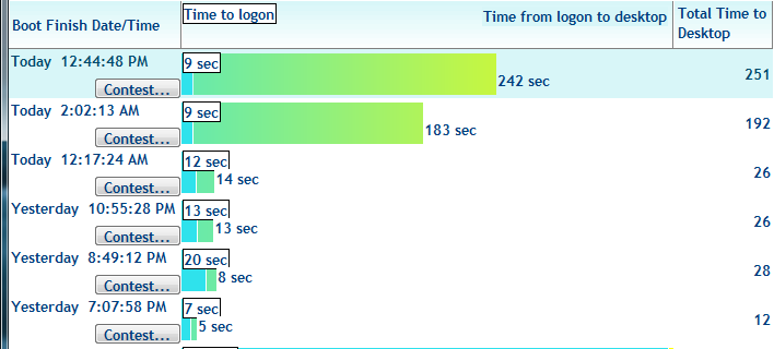

Hope so, I dread having to reboot the damn thing. I think the issue is with a .NET Framework update via Windows Update. The computer runs fine until I apply all the Windows Updates then the boot time takes a dive.
*EDIT*
Ran BootRacer and it confirmed my 5 minute suspicion...

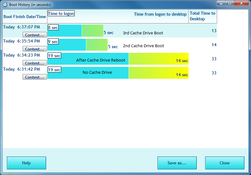

Ok got the drive installed along with the PCIe 1X USB 3.0 card I ordered. So far I'm getting really annoyed. Nothing is working like I hoped it would. The USB card is transferring slower than the onboard USB 2.0 ports did.
Then to top it off the boot times have gotten worse. The only thing that's interesting is after installing the cache drive and USB card the computer booted fine (under a minute). Installed the cache software rebooted and it took over 6 minutes. Ideas?

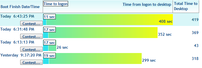

Appears too that the boot times are constantly getting worse.
Untitled-1 copy.png (38.1 KiB) Viewed 57867 times

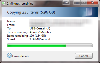

I'm starting to think this has to do with PCIe lanes. When I attached my USB 3.0 drive to the card my PCIe WiFi card would drop the connection. So I just tried to reboot after pulling the USB 3.0 card and disconnecting the DVD burner. Only things attached now are the 2 hard drives and the video card. Small improvement but it still sucks.
Time to Login: 11
Login to Desktop: 355
Total: 366

I installed the new USB 3.0 card in my main machine to see if it was faulty. In short, no it's not. So now I'm contemplating reinstalling Windows but I really don't want to do that with the number of applications I have installed. I have noticed that programs are a lot snappier to open, though they aren't nearly as quick as a stand alone SSD. If I had to sum up the performance gain I'd say it's comparable to when I had two of these Samsung Spinpoint F1s in RAID 0.
USB Results - click to enlarge.

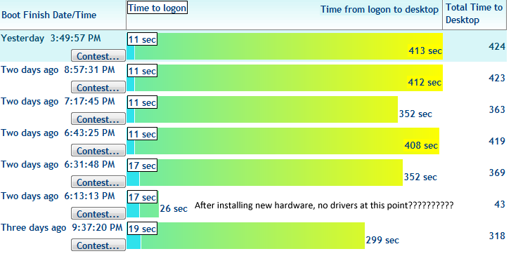

Another small update. Just uninstalled a bunch of stuff I wasn't using. Ran some registry cleaners and that didn't help one iota.
Re: Corsair Accelerator 30GB On The Way
Posted: Sun Jun 17, 2012 2:28 pm
by Major_A
Finally broke down and reinstalled Windows yesterday. Here are the new results.
Problem is after installing some apps I'm right back to where I was before.
I did notice that the boot times went through the roof after I turned on Malewarebytes active protection. I uninstalled it and still have ungodly long boot times.

egloeckle wrote:I really hope I am replying on the live server to this....
Did disabling all startup programs and non-essential services make a difference? Make sure you disable non-essential microsoft ones as well including the .net NGEN services.
If doing that does not make a difference, the problem is a much larger PITA and is a driver being loaded into the system. Any odd devices buried anywhere in device manager that may have been added by some software? I doubt it will be that easy, but it is a good place to start.
I did try setting the NGEN services to manual but it didn't help. It could be a driver issue. My internet has been down most of the time for the last 3 days and I was finally able to download the Catalyst drivers. Seems like those were the last drivers I installed before all this started happening.
DragonFury wrote:I never had an issue with .net did you go into the Msconfig? Hmm I will have to think on this a bit more. that does not look like msconfig on any windows I messed with.
That's the Startup tab for CCleaner, same thing as MSConfig. Only with CCleaner you can delete entries instead of just turning them off.
kenc51 wrote:Try disconnecting the SSD, boot off the mechanical disk and run a thorough defrag
The drive shouldn't be fragmented. I installed Windows Saturday evening. But I'll give it a shot. You think I need to disable the cache drive to defrag the mechanical drive?
Thanks for all the help and suggestions. Keep them coming.
