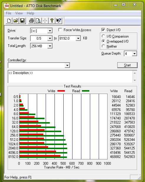

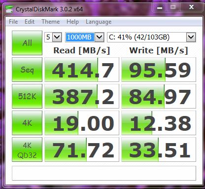

This is what I got with the CrystalDiskMark and the ATTO Benchmark programs. This was done in Windows 7, but was done from an SSD that was copied from a partition on a platter drive. This is using the 2006 generic msahci drive, I have read a lot of negative stuff about using the AMD AHCI drivers and how hard it is to get rid of them once you do install them.
CrystalDisk SSD Benchmark.jpg (34.6 KiB) Viewed 88453 times
ATTO SSD Benchmark.jpg (60.17 KiB) Viewed 88453 times
The writes don't look too good on the CrystalDiskMark bench, but looks better on the ATTO bench. What do you think?

Writes seem low on both accounts although if the drive being tested is also the OS drive, the results will be less than optimal.

ATTO is what all the manufacturers seem to use since it shows the fast and most generic results. Since ATTO reported that you are running roughly 500MB/s for read and write you are maxing out the SATA III port. Like FZ1 said too that since it's your OS drive there is overhead from Windows. Most if not all SSD reviews on the net are with the SSD being a non-OS drive to get the "best" results.

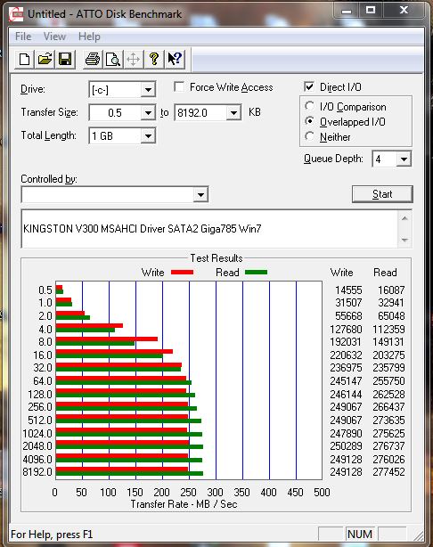

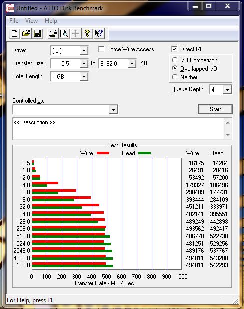

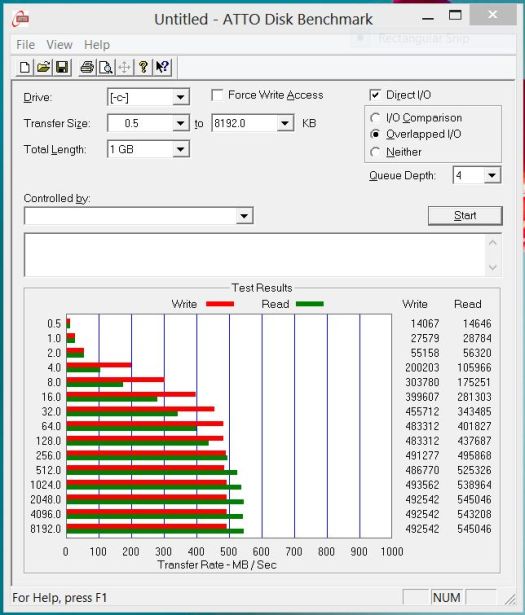

Here is ATTO for all three of my SSDs with O/S's post-alignment. The Giga785 is a SATA2 mobo running Win7 (main utility, torrents, etc. lots of programs and junk) and seems to be saturated, and the other two SSDs are on the ASUS890 board SATA3 mobo, one drive running Win7 the other running Win8, they seem to be doing their job at least as well as can be expected for budget $80 SSDs :) All are using the generic M$ driver. Major_A your ATTO is a little higher probably due to your Intel chipset and using the Intel driver which I've heard is better than the M$ or the AMD SATA drivers.
ATTO SSD Benchmark MSAHCI Gigabyte785 Board.jpg (81 KiB) Viewed 88316 times
ATTO SSD Benchmark Win7 ASUS890 msahci SATAIII.jpg (79.71 KiB) Viewed 88316 times
ATTO SSD Benchmark Win8 ASUS890 storahci SATAIII.JPG (63.87 KiB) Viewed 88316 times
