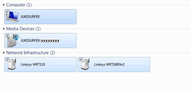

I don't have any network shares, no printers on the network, I don't have homegroup set up because right now I don't share between the computers on my network. This is what my network window looks like:
Those two routers aren't in my network (I use a DIR-850L) but I was told that since they are within range of my adapter on this box (main level) Windows7 has them listed in there for ease of joining those networks with wifi direct if I so desire (click to configure and it asks for pin numbers). I don't know why those two particular ones show up when I have 20 neighbors' wifi networks show up on my adapter's connections lists, maybe it is because these two routers have networks that are open with no security setup? I do see two networks that are unsecured at the time of this writing (coincidence?), one of them labelled "GoldCheetah-guest" is setup as a pay-by-the-hour connection since I tried hooking to it once and it popped up a paywall. Methinks if their provider knew about that they would lose their service, lol. If they have Charter like I do, they would be in trouble for it I'm sure.

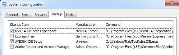

for reference, my boot time with my i7 at 4GHz and a Toshiba 128GB SATA3 SSD (on a SATA2 controller) is about 20-25seconds from powered off to fully loaded desktop, again with no AV at boot (have MBAM free I use only if needed)
I should actually kill GeForce experience while I'm at it 8-[
