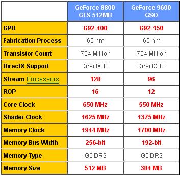

However, a method for soft-modding an NVIDIA GeForce 9600 GSO into an NVIDIA GeForce 8800 GTS 512MB has been found. This mod instantly gives you a GeForce 8800 GTS 512MB card at half the cost!
Determining The Modding Possibility
Both the GeForce 8800 GTS 512MB and the GeForce 9600 GSO graphics cards use the NVIDIA G92 GPU. Performance binning of the G92 GPUs results in two different grades - those with all 128 fully-functioning stream processors are labelled as the G92-400 and used in the GeForce 8800 GTS 512MB cards, while those with at least 96 fully-functioning stream processors are labelled as the G92-150 and used in lower-end cards like the GeForce 9600 GSO.
Do note that some GeForce 9600 GSO cards might be using G92 GPUs will all 128 stream processors fully-functional. This is because NVIDIA has to deliver their GPUs according to market forces and not entirely according to the speed binning. So some, if not many, fully-functional G92 GPUs may end up getting used in the GeForce 9600 GSO.
That is not all though. To properly mod a GeForce 9600 GSO into a GeForce 8800 GTS 512MB, you must look for GeForce 9600 GSO graphics cards that have 8 GDDR3 memory chips. This is important as the GeForce 9600 GSO only requires 6 memory chips to achieve the memory capacity of 384 MB with a 192-bit memory bus. Therefore, most GeForce 9600 GSO cards only come with 6 GDDR3 memory chips.
The good news is there are some GeForce 9600 GSO cards that come with 8 GDDR3 memory chips. To simplify production, some companies choose to produce a single PCB design with 8 GDDR3 chips, and then create two different products by choosing the GPU to use. NVIDIA locked 32 of the 128 stream processors in the G92-150, so by using that GPU, the graphics card turns into a GeForce 9600 GSO. If the company wants to create a GeForce 8800 GTS 512MB card, they just need to use a G92-400 GPU instead.
So, when you look for a GeForce 9600 GSO, make sure it has 8 GDDR3 memory chips. That will give you a real good chance at modding the card into a GeForce 8800 GTS 512MB. With that said, there is no way for anyone to know for sure if the GeForce 9600 GSO has faulty stream processors or merely had them locked for marketing purposes.
If you have such a card, then let's proceed with the mod guide!

With that said, the mod has some risks. If you mod a GeForce 9600 GSO that only has 6 memory chips, then the card will likely crash as soon as you load a 3D game that uses more memory than the 384 MB that the card actually comes with.
In addition, not all GeForce 9600 GSO cards will have fully-functional GPUs. At least some of the GPUs will have faulty stream processors. If you mod a GeForce 9600 GSO with such a "defective" GPU, then you will notice either visual artifacts in your 3D games, or the card will crash when running 3D games.
Last but not least, the soft mod will automatically overclock your GeForce 9600 GSO to the GeForce 8800 GTS 512MB's clock speeds. Your graphics card may not be able to run at those clock speeds. If so, it may crash in 3D games.
The good news is you can always flash the previous graphics BIOS into your graphics card. Just make sure you SAVE your old BIOS before flashing the modded BIOS!
