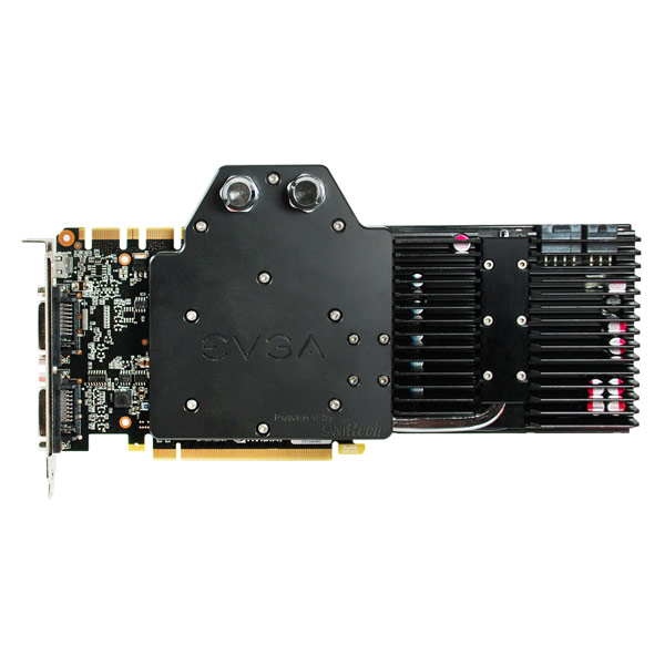

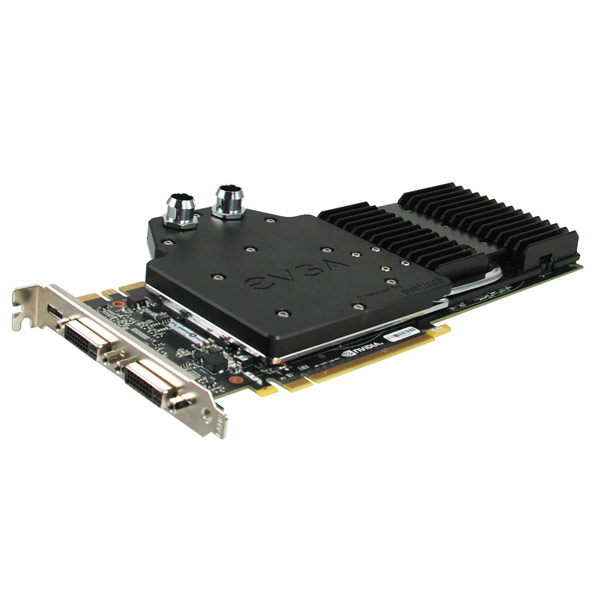

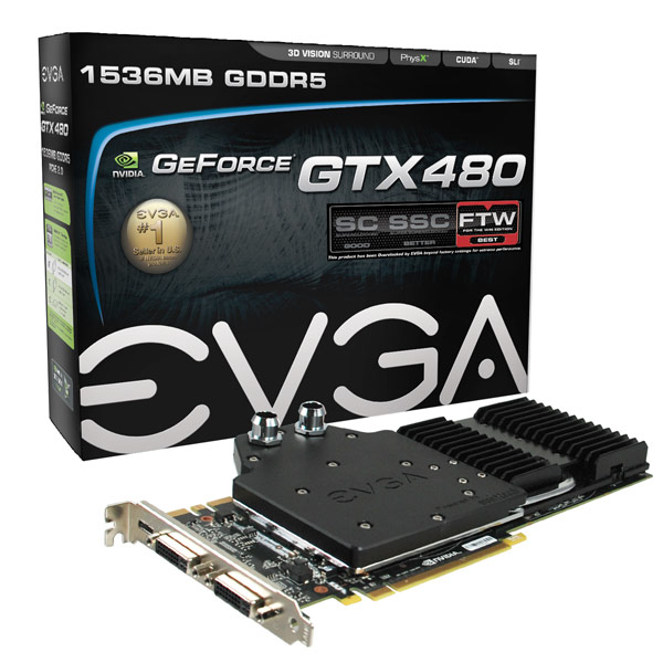

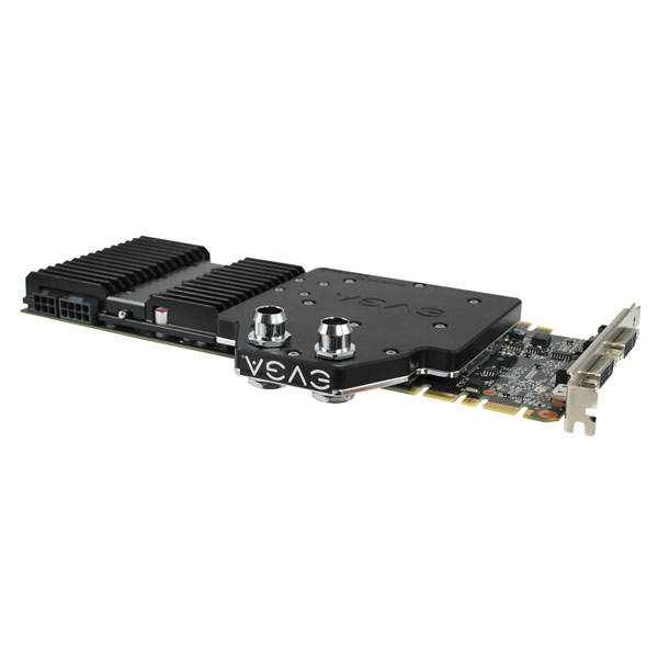

EVGA GTX 480/470 Hydro Copper FTW – Be Cool
The world’s fastest GPU now meets the world’s best waterblock. EVGA teamed up with Swiftech to deliver a solution that truly goes “For The Win!” The EVGA Hydro Copper waterblock uses a 0.6x0.6mm thin pin matrix, and the base plate is made of chrome plated electrolytic C110 copper which gives it a clean look. The integrated heat pipe connects to the power mosfet heatsink for optimal cooling.

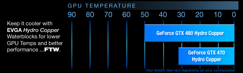

High performance, high flow fittings are also included in both 1/2” and 3/8” sizes. These barbs are 2-way, 3-way and even 4-way SLI compatible! Below is an example of the remarkable GPU temperature difference:
GeForce GTX 480 Hydro Copper FTW
Part Number - 015-P3-1489-AR
Core Clock Speed - 750MHz
CUDA Cores - 480
Memory Clock Speed - 3800MHz
Memory Bandwidth - 182.4GB/sec
Shader Clock Speed - 1500MHz
Bus - PCI-E 2.0
Interface - DVI-I, DVI-I, Mini-HDMI
Product Warranty - Limited Lifetime warranty (Upon registration within 30 days)
Requirements
- Minimum of a 600 Watt power supply. (Minimum recommended power supply with +12 Volt current rating of 42 Amps.)
- An available 6-pin PCI-E power connector and an available 8 pin PCI-E power connector

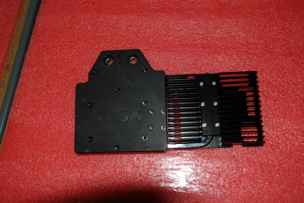

Here is the outside of the waterblock:

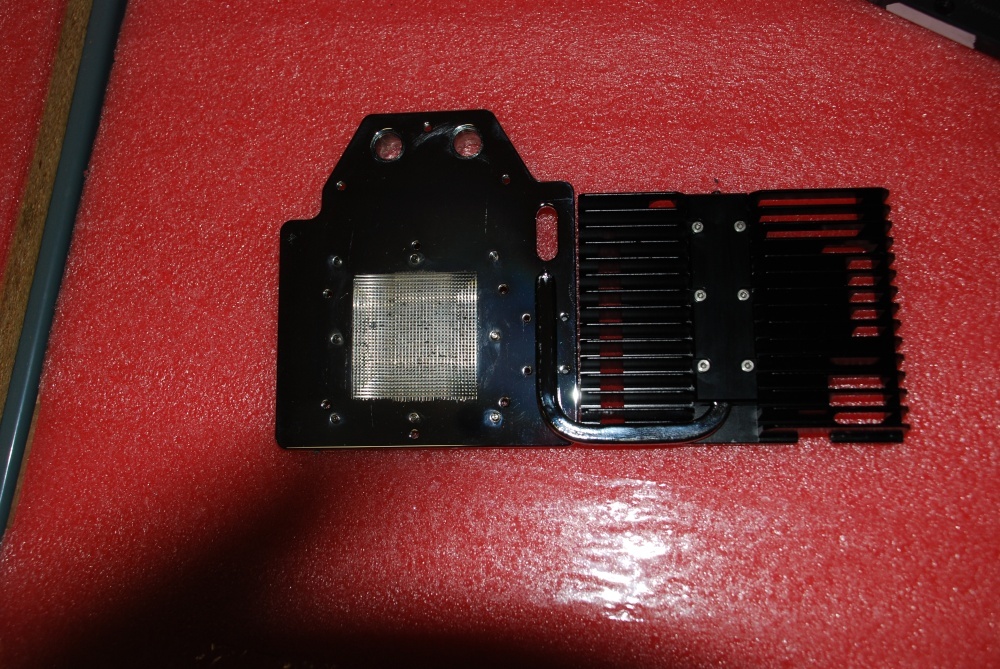

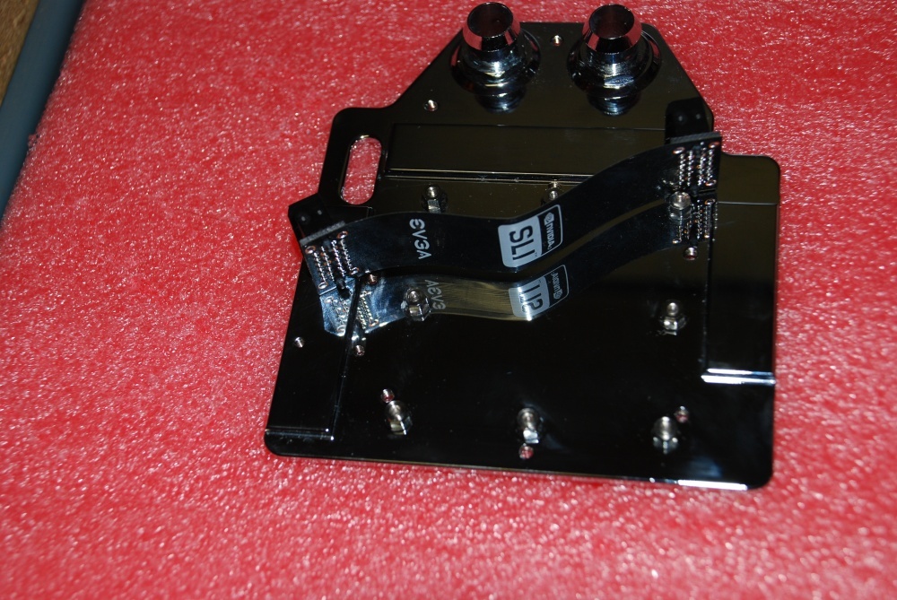

If you take off the top, you can see the internals, and the integrated heatpipe to the VRMs

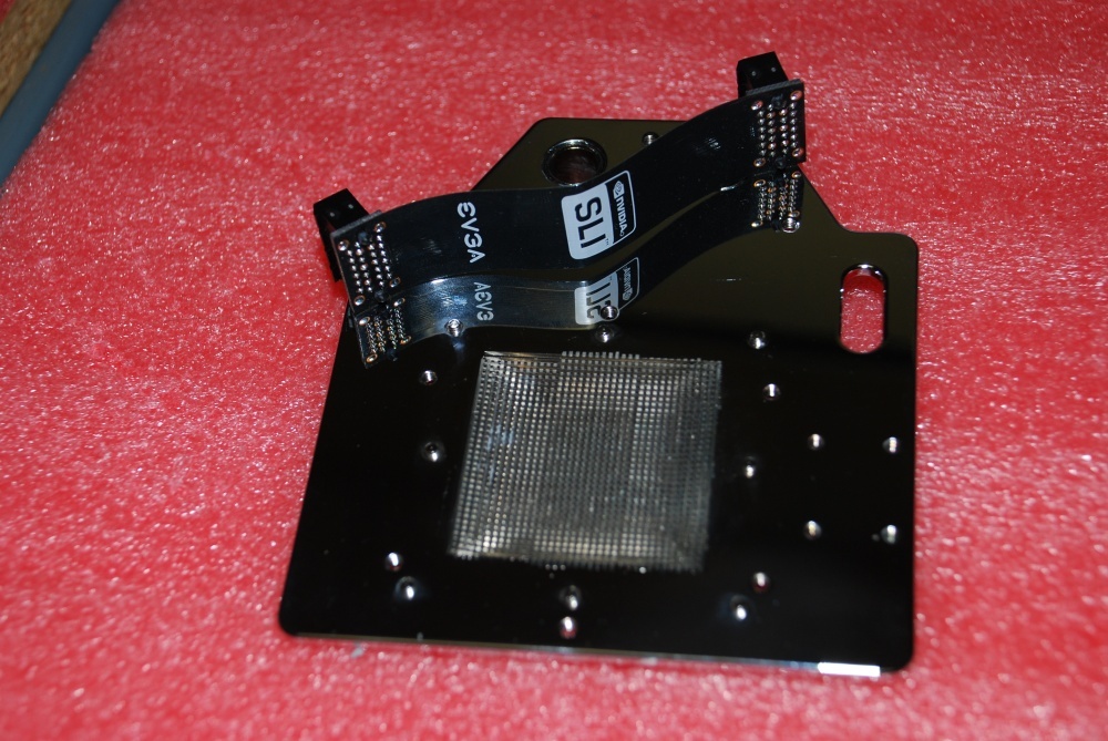

A closer look at the internals, and you can see the 0.6mm thin pin matrix, and the reflective properties of the block itself.
Here is the back of the block, all the memory are cooled, and once again you can see the smoothness of the block where it contacts the memory and GPU.

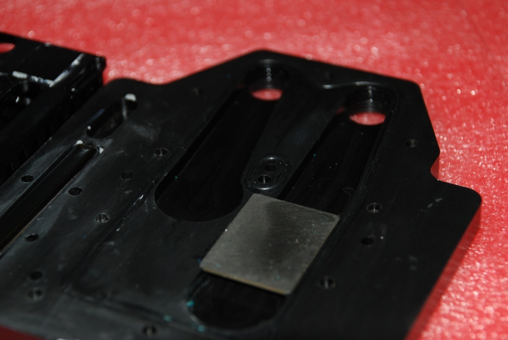

Lastly we have the inside of the top delrin piece, here you can see the flowpath, and separator.
Of course none of this would matter if we didn't have good performance, so here are load performance numbers for both the GTX 480/470:
GTX 470
Load Heatsink: 83c
Load Waterblock: 38c
GTX 480
Load Heatsink: 95c
Load Waterblock: 49c
