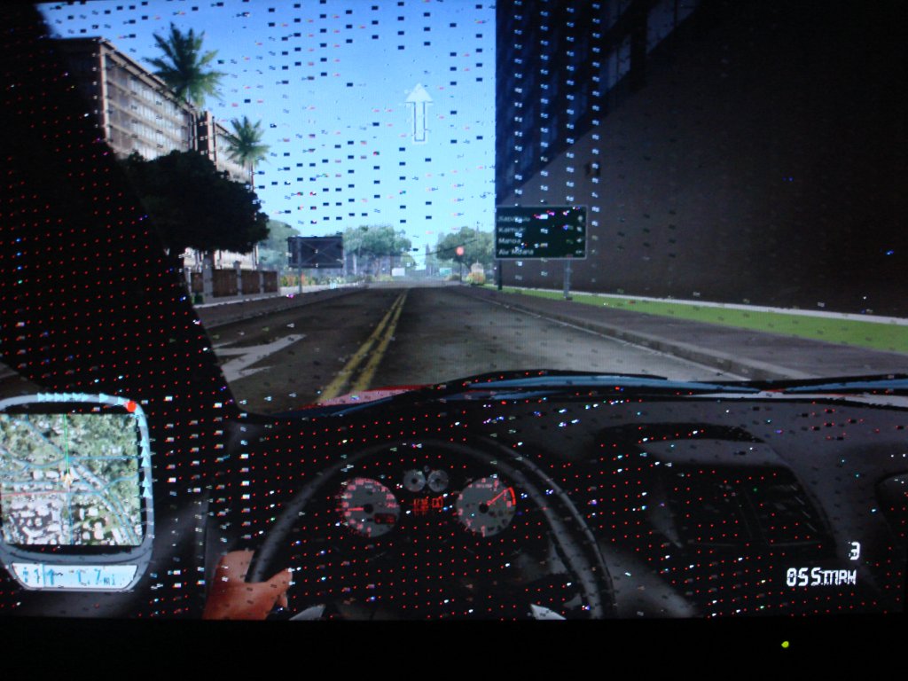

Whenever I play an intense 3D application my system randomly crashes. It becomes frozen at this screen. It seems to be random, sometimes I can play for hours without problems, sometimes it crashes after 15 minutes. My old video card (6600GT) didn't do this. What do you think is going on here? Bad mobo, video card, not enough power? It only happens in the most graphically demanding games. All clock speeds are stock.

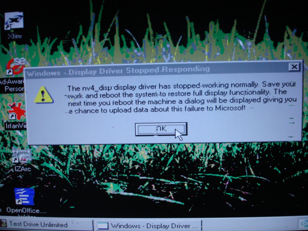

I got this afterwards.

that would be artifacting, typically caused by overheating possibly caused by over clocking

Everything looks fine until one second it crashes and thats when the artifacts appear. The artifacts appear at the same time it locks up. I thought artifacts gradually appear as the card heats up.

It is not artifacting. There is no artifacts until the crash. At which point the computer locks up. After a few minutes it will display a "no signal" message on the monitor.
