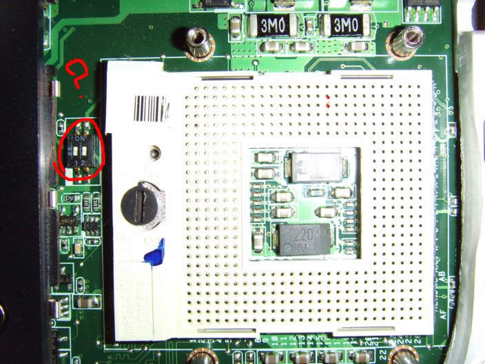

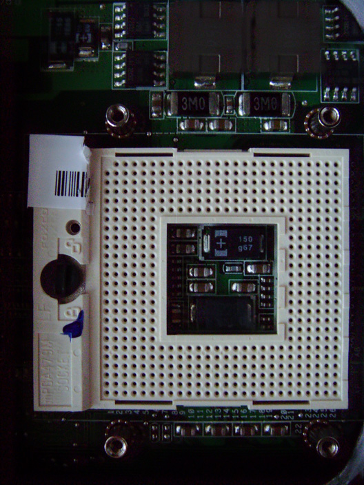

Ok i think it didnt work. i looked at different forums about overclocking pentium m. but the result came all out the same. My Asus A6vm with 735 still getting 1700mhz read off the bios and cpuz. I also did volt modd earlier but there is no point
here my config
PIN MODDED: @attach1
ORIGINAL: @attach2
i knowtice there is a little switch, is that the one? (red ring)
If yes what is 133bus is? 1off2on? or 1on2off?
EDIT:
Problem solved with the switch> 1off2on ,now its running 2260 mhz!!
