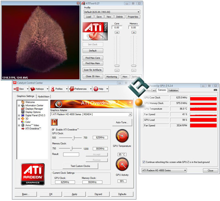

I started out with the card on automatic fan speed (the factory default setting) and found it to peak at 85C... The fan is only spinning at 41% and doesn't go any faster than this.

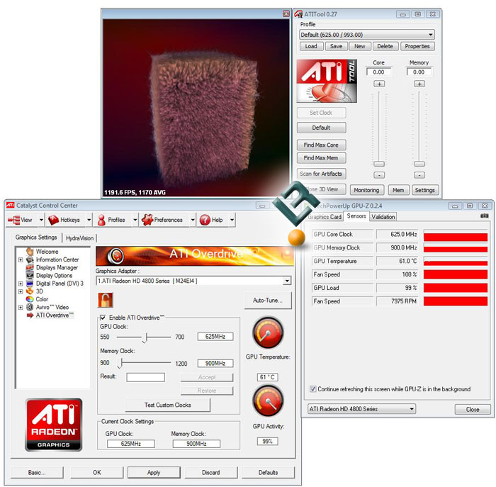

With the fan speed manually set to 100% the temperature dropped from 85C to 61C, which is a 24C temperature drop by just making a custom profile. The fan is way too loud at 100% though, so I grabbed the decibel meter and found it to be at 77dB at 100% rotation (the fan is spinning at 8,000 RPM, which is hella fast)... Just figured I'd post this up as other Radeon HD 4850 and Radeon HD 4870 owners might be looking for a way to lower their temperatures or increase the fan speed on these Radeon cards. Having the fan set to 60-70% seems to be the sweet spot, if you are wanting a nice mix of cooling and noise.
