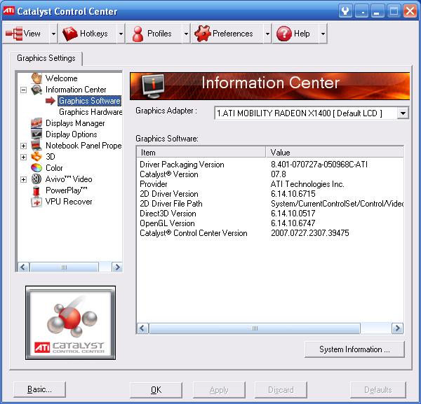

I don't think there's a need to install the 7.8's if your running a x1800 series. I think DAMIT have stopped developing drivers for that series.
@ krazy1912
If your using a laptop, the ATI drivers are prolly not supported. I know Dell refuse to allow ATI to support their cards. The drivers will work, but the driver won't install.
You'll have to install the drivers from the laptop manufacturer or else use a tool called "Mobility Modder" to install them

:edit:
The tool in the above link works!
See screenshot, my Inspiron 6400 with X1400 running the 7.8's
