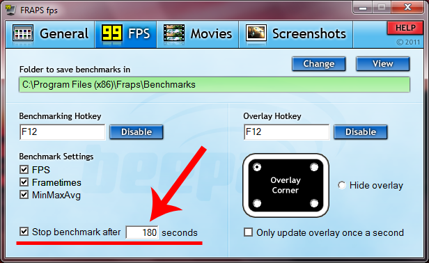

Do me a favor. Download FRAPS and setup a benchmark (see attachment). From there post the results here with the good and bad driver.

That's why I showed you the example. FRAPS is set to record your framerates over 3 minutes, in my example. Meaning start the game, hit the button assigned (F12, example), then start playing the game. Do that for both sets of drivers. Then show the log file to us (Min/Avg/Max FPS) for both drivers. This isn't about posting a picture it's about seeing what your framerates are doing with the different drivers.

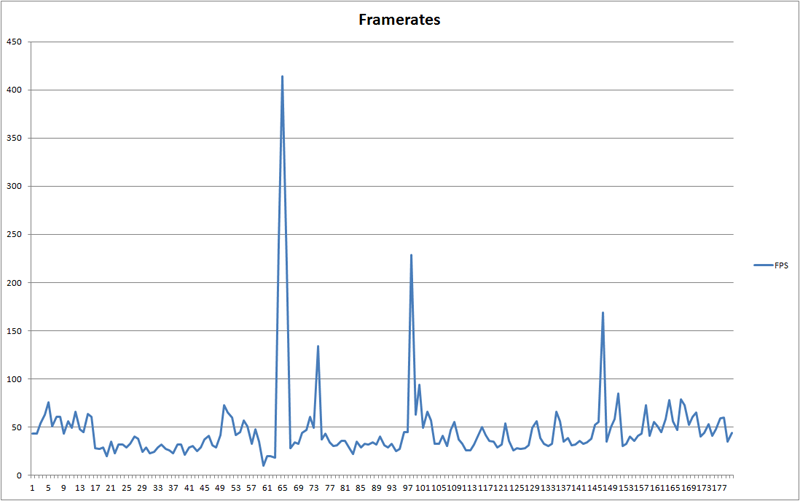

I just ran a 180 second benchmark and this is the information I got from FRAPS.
1. Frames: 8582
Time (ms): 180000
Min: 9
Max: 417
Avg: 47.678
2.Frames: 8582
Time (ms): 180000
Min: 9
Max: 417
Avg: 47.678
3. I was able to create a graph over the course of the 180 seconds.

You can turn off V-Sync. See my first screenshot. The program tells you what button to press to start the benchmark. It also tells you where to find the results (you'll need Excel to open them up). If you don't have MS Office grab OpenOffice to open the results. Use my screenshot of FRAPS to help you get started.

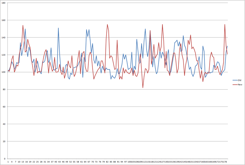

They are all out of align besides FPS. I cant tell what number go in what column. Can I upload the benchmark files? used openoffice. I also noticed that my frames didnt go below 80 and it was still jittery.
Re: Radeon HD 5500 low frames after driver update
Posted: Wed Feb 29, 2012 5:23 pm
by Major_A
Did you run this with both drivers? You can try to upload the results I don't know if the forum will take them. Alternatively you can upload them to Mediafire and post that link.
http://www.mediafire.com/
Posted: Wed Feb 29, 2012 5:26 pm
by peronmls
yeah upload anywhere that what i mean and im going to test it with the old driver now
EDIT:
Here are all the files with both old and new drivers used.
http://www.mediafire.com/?7au9rn77i1331k3
Posted: Wed Feb 29, 2012 7:55 pm
by Major_A

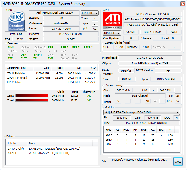

Did you start the game in the same spot and run around doing generally the same things with both runs? There are some changes in FRAPS. But there isn't anything in either that would indicate and issue. Looking back at your hardware to give more suggestions you have a serious hardware error. You say you have an Intel CoreDuo with an AMD motherboard. Download HWiNFO32 and post up a screenshot of the summary page.

Yes I did do it in the same spot and ran around in the same path. and no i don't have an Intel Processor I never said that. I have a AMD Athlon II X2. and a intel processor with AMD MoBo... is that even possible?

Make sure your RAM is running at the correct speeds. Per HWiNFO32's screenshot you have it overclocked. If you are indeed running it at 667MHz then make sure the timings are at 9-9-9-24 instead of the 7-7-7-20 it's showing.
Completely uninstall your old video card drivers with Driver Sweeper, reboot after the sweep, then install the latest drivers.
Driver Sweeper: http://phyxion.net/Driver-Sweeper/Driver-Sweeper/
Latest Beta GPU Drivers: http://194.71.11.69/pub/games/PC/guru3d ... com%5D.exe
I see you have your CPU overclocked (240x15?). Try putting your CPU back to stock speed and see what happens. I know with AMD if you start to mess with the FSB and don't tweak the other options accordingly then things can get wonky.
