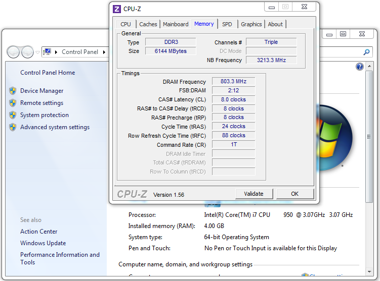

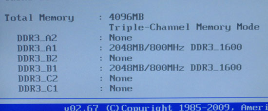

Well as stated in the subject, I am not sure what to believe as far as how much memory my system is using. I have 6gb installed in triple channel mode. In the BIOS it is seeing 4Gb only, windows says it is 4gb, CPUz says 6gb, WTF? I have shifted sticks around in triple channel and same result. Take the sticks out of triple channel and they show up in the BIOS fine. I am thinking that I have a dead memory slot...but it shows up in cpuz, I'm just a bit confused
BIOS Shot
BIOS Shot
CPUz and windows
CPUz and windows
If you have any suggestions I am all ears. I am running the latest available BIOS on the ASRock X58 Extreme3 board and the memory is a set of Corsair Dominator 1600MHz
