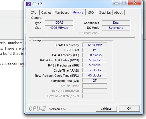

oh okay, yes those are the most/only important timings, at 1066 you would have to run around 5-5-5-18-2T 2.1v I would guess though as that is what my native 1066 Reaper HPC kit runs, but here are my Reapers at 858 MHz, 1.88v

Thanks for the screenpic, I'll check those against the current settings later today when I can reclaim the TV (this is in my htpc).
