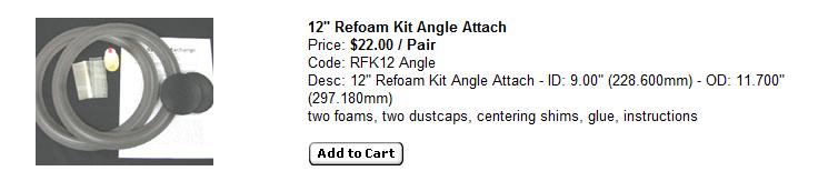

would it be worth getting this for the 12's instead of going new? it'd save like $40

Refinishing speakers is really an art more than a hobby. If you put glue on the wrong part it will eat clear through the cone. If you put to much glue on one side of the cone than the other it'll buzz as the cones now unbalanced. Really, if you're going to spend the money spend the money.
I used to have a set of Accoustic Research AR series back in the late 90's. They were some of the best sounding speakers I'd ever heard. Blew a seal on one of the woofers. Tried to have a professional in town repair them by rebuilding them. Ended up destroying the drivers.
Skiier might get lucky and have the right touch for doing it. But to spend $25 on something that may destroy the driver causing thim to have to replace it anyway seems a gamble.
These refinishing kits are more for old Hi-Fi cabinets where sound quality isn't so much an issue as not being able to find a replacement driver is.

okay, i'll go new and get speakers that would be much better(much bigger magnet at least)
