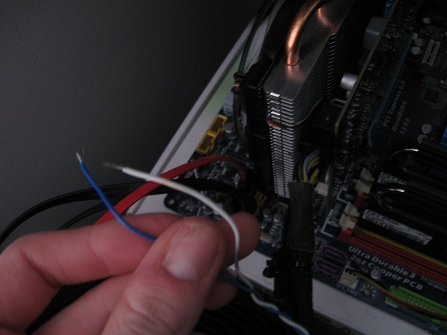

this is my power button for my on-desk setup
was originally a dead reset button, but i chopped off the button part and stripped the wires because it is a lot easier than always starting it with a screwdriver
the only thing that buttons do is create a short between a specific pair or group of wires/contacts, so figure out what pins are for the PW and RES (Power/Reset) and replace the buttons, or you can just splice little headers to the end of the button wires like from LEDS or even from an in-chassis speaker
