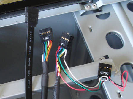

if you have the front I/O cable hooked up to the HD plug not the AC97 plug it will cause the audio not to work. Unplug the cable and I bet it starts working.
If it does, look at the plug on the cable, it should be labeled AC97 or HD

I was referring to the cable in the case, not the board. The cables have two plugs on them, I think he has the HD plug hooked up to the AC97 header. The plugs are not wired the same, its most likely causing a signal issue.

bubba, i wussed out... i opened it back up and wasnt brave enough to mess with what was already plugged in. my stuff isnt labeled as nicely as in your pic. BUT... when we put this thing together we left the front ports unplugged cuz the cable didnt reach where we were supposed to plug it in, i said screw it. leave it...
this time i made it reach (gently) got it plugged in and voila. SOUND!
